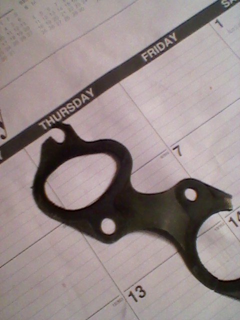

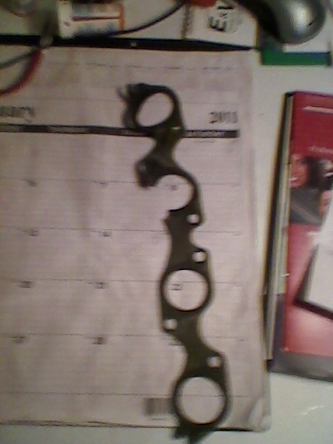

Replaced the intake manifold gasket today and what a surprise. Someone had already replaced the gasket once already and somehow missed a stud while installing. On calendar 1 the gasket wasn't even close to sealing the intake. I there was probably a 1/4 inch gap straight out to fresh air. Check out the pix of the crush-formed gasket.

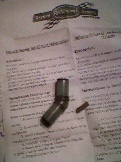

In the process of replacing the gasket, I broke a little stem off a t valve that goes into the flame trap I believe. I cant seem to find a place that sells a replacement. any ideas where I could find one? I included a picture of that as well.
PS it idles almost as smooth as silk now.
