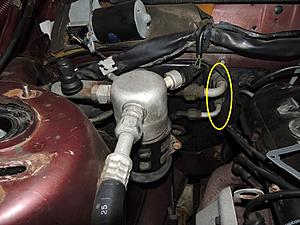

The evaporator in the R12 car just has hoses going into the evaporator, the 134a set up on my donor car has hard lines going into the passenger compartment, circled in yellow, so I assume if I were to change to the 134a dryer I would have to swap out the evaporator under the dash?
You do not have to change the evaporator. They make a flush kit to just flush it out. The reason is to get out any oil from the R12 compressor. Same with the compressor where all you need to do is flush it out and empty all of the oil in it.
