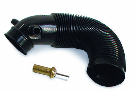

New problem developed and the Bently manual has not been helpful for this one either. While I was tooling today I noticed a loose hose attached to the air hose running from the MAFS to the throttle body. There are two, one running up and to the left (attached) and another running out of the right side (not attached). I'm not sure if it has been loose or if I knocked it loose but I couldn't find where it should be reattached to and what it does. I'm sure this isn't helping my cause, as now I have unmetered air past the MAFS. Any clarification would be great! in the picture ripped from Google below, the hose attached to the top left opening (how much more confusing can I make this?)

re hoses to the MAF, I don't think there are ANY vacuum lines connecting to the MAF, just the intake hose from the airbox, and the intake hose between the MAF and throttle body. Of course, there's an electrical connection to it.
Primary vacuum hoses include brake booster, chrysler ignition controller, heating/air controller (in dash), and the charcoal cannister (under the airbox). I'm probably forgetting a couple. oh, cruise control, if you have it.
Old Jul 21, 2015 | 07:16 PM
oh, that fitting near the throttle body, I believe thats for the crankcase ventilation aka flame trap.

The hose that attaches to the upper-left nipple shown in your image is supposed to be connected to the flame trap - which should be located between the 3rd & 4th intake manifold runners. Indeed, if this hose is missing, there is unmetered air entering the throttle body that could lead to drivability issues. I would make sure that your accordion intake hose is leak-free first, then adjust the throttle position sensor as per the Bentley manual before springing any money for the new MAF. For the flame trap hose, IPD sells a relocation kit for your model. Check it out here:

In regards to the flame trap, I believe that's the one. I tried to take a picture, as it looks like I need a clamp and a longer hose than what I currently have. Will look into the ipd relocation kit suggested.
