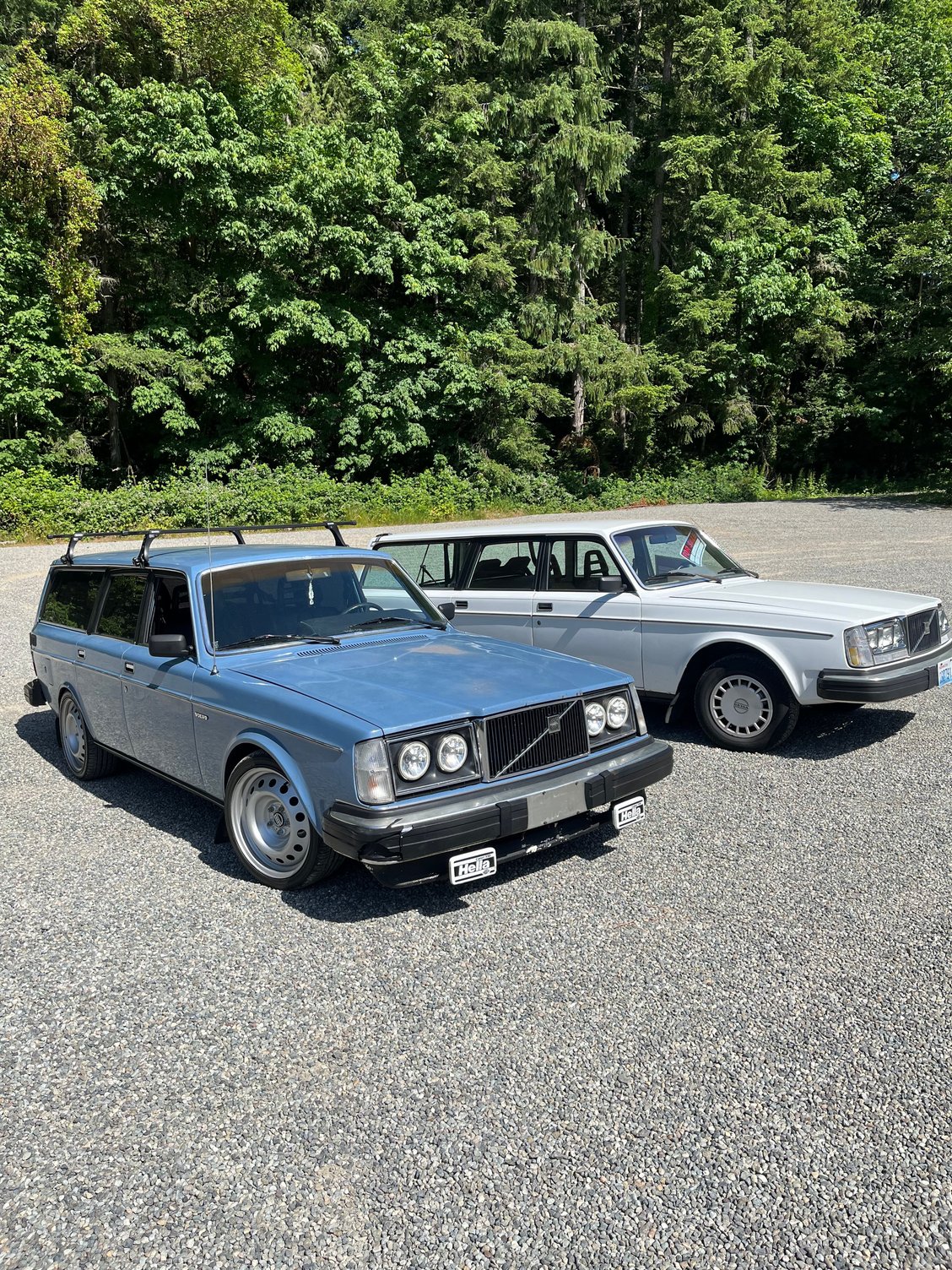

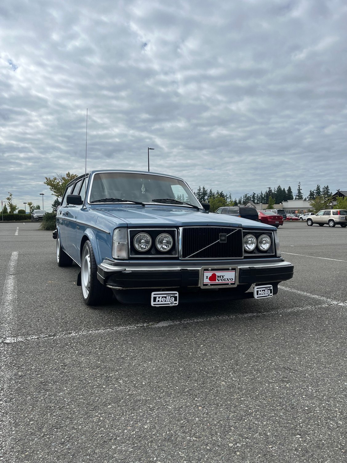

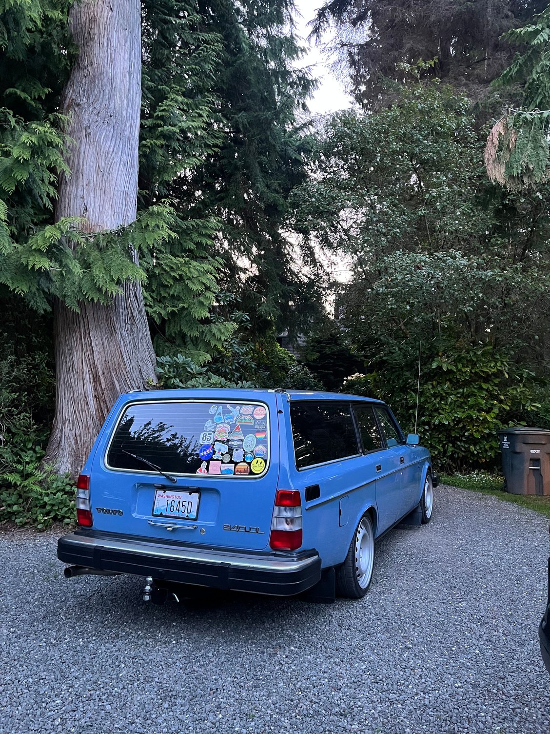

Hey I’m working on my ‘82 245 with the 2.1, 4 speed and I’m having trouble finding a set of engine/transmission mounts that are a little stiffer than usual, when I let the clutch out I can feel bumping from under the car, as well as the shifter moves a lot in like a circular direction. I’ve tried the standard auto parts store set for $20, or the IPD “heavy duty” ones that are from the diesel model. Both still have a lot of movement. I actually had to beat up my exhaust to get it to stop hitting the floor. I know a lot of mounts are meant to break in an accident but honestly I’d rather have a set that don’t shake so much. I do have a bigger driveshaft with a big transmission yoke, but it clears the floor with about 1 inch all the way around. Any help on this would be awesome.

And that's a Nice looking 1982! Still have the original fuel injection?

and yes it does still have the Jetronic system and it runs beautifully! Only issue now is these mounts
