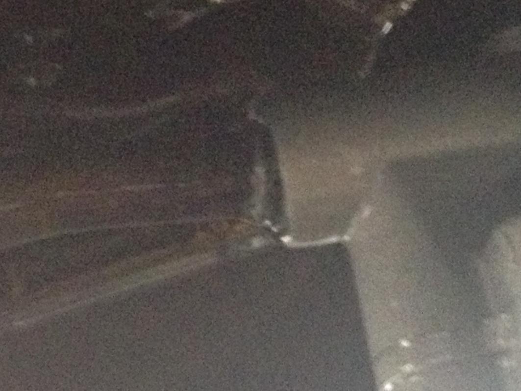

Had zero oil pressure, no oil moving at all, and pump was replaced, I was thinking the O-rings. It wasn't quite the O-rings but close.
So, dropped the pan and found the connection at the feeder pipe to the pump looked like this:
Obviously not a good seal. The O-ring was new but there was wiggle room in the pipe, the other seal in the block was similar.
Was able to order a new feeder pipe and you can see in the picture the original pipe (bottom in the pic) has is bent on the horizontal which would connect to the pump. In full disclosure, I probably bent the pipe when I tried reinstalling it with the pan only dropped half way, the Haynes way.
