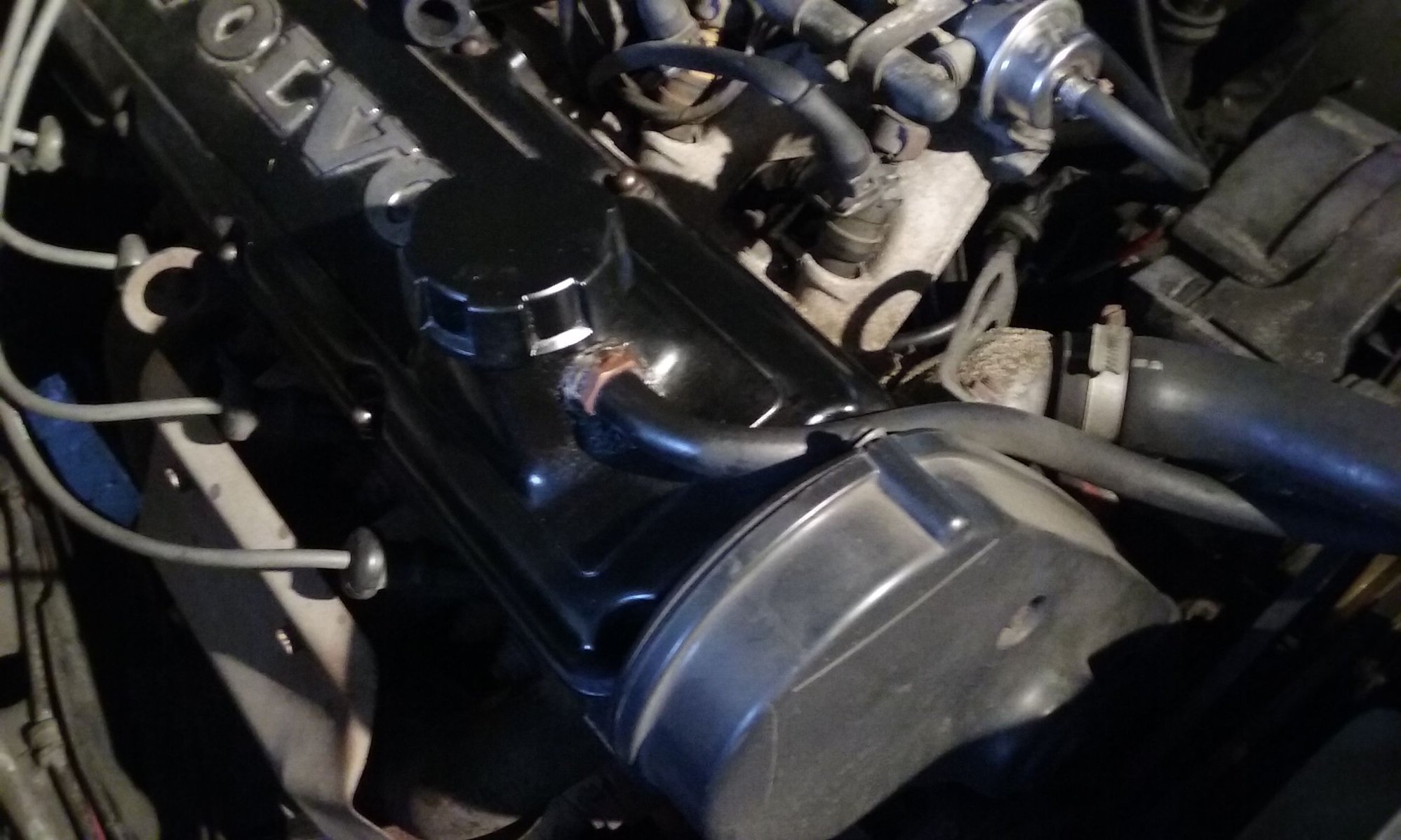

Well the car sounded funny when my bride pulled it in today and low and behold we had oil coming out of the oil fill cap . I also put a vent tube near the cap but the pressure was to great. I popped the nipple out of the oil/pcv trap and no pressure could be felt. So looks like maybe tomorrow or wednesday I'll be pulling the oil trap assembly. I just did this about 150K miles ago. I do have a new trap that I bough a while back so I'll be installing that. I do recall I did replace it without removing the manifold and maybe a good time to clean the throttle body. Just a little more fun but the real PITA is gonna be hosing down the block in 30* weather.

Car has 375,000 miles on it and I last changed the PCV trap assembly at 150,000 miles. At that time I bough another cam cover and drilled a 1/2 " hole below the oil fill cap and routed a hose to a catch can. Just to re-leave pressure in the head. So the PCV nipple is clear and if you put your finger over the rubber hose (remove the nipple) with the engine running there is no pressure there . Also the rubber gasket under the oil fill cap is now leaking so oil is spitting out and down the side of the block. The last time this happened I replaced the PCV oil trap plastic box. I'll be doing that in the next few days along with cleaning the throttle body and then my 5K oil change.

It is obvious I must be obsessed with this but just trying to picture the cause. This morning I cut the old plastic PCV box in half at the seam . Nothing obvious as it just has a few baffles inside where the liquid oil runs to the hole going into the oil pan and the vapor going out of the top into the flame arrestor nipple. Pretty simple and is basically a cheap oil catch can. With winter here in the NE I'll wait until spring and then decide when I'll want to open it up and check the block. For now I've got a patch in place by dumping the cam cover pressure into a separate catch can. Also I've double gasket-ed the oil cap so the pressure goes into the catch can. Just a rube goldberg set up but it keeps the oil off of the engine and preserves the seals. FOr now I'll just move forward. Oh if anyone wants me to post a picture of the OEM oil PCV tank cut in half I'll do it before I throw it out.
