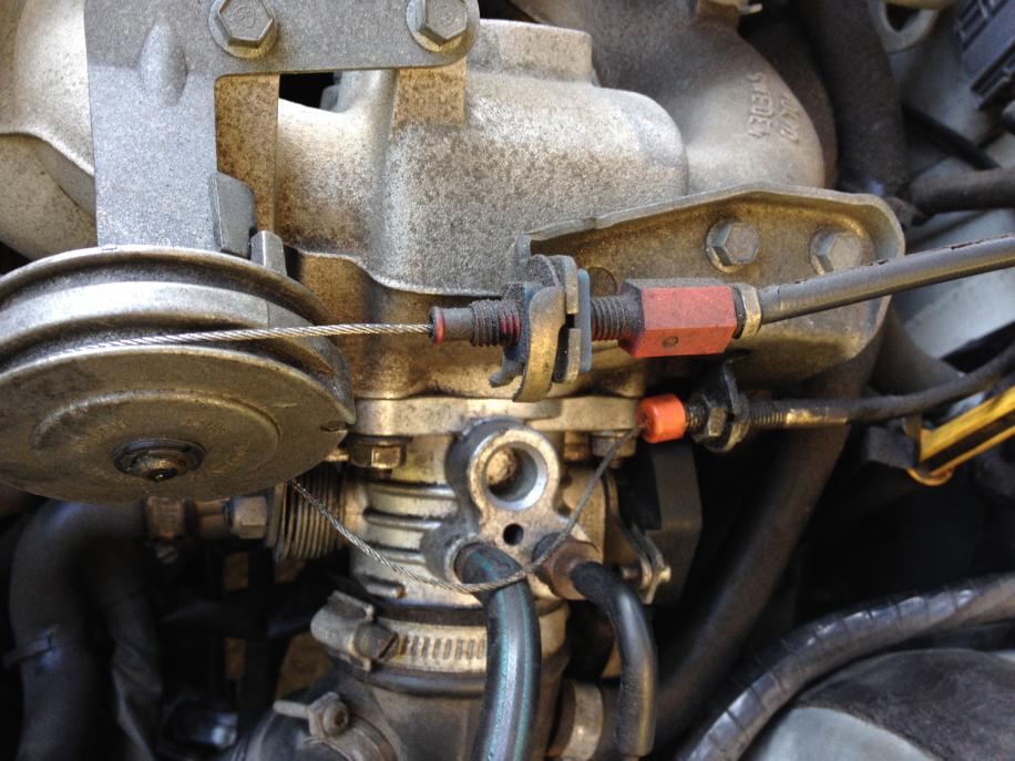

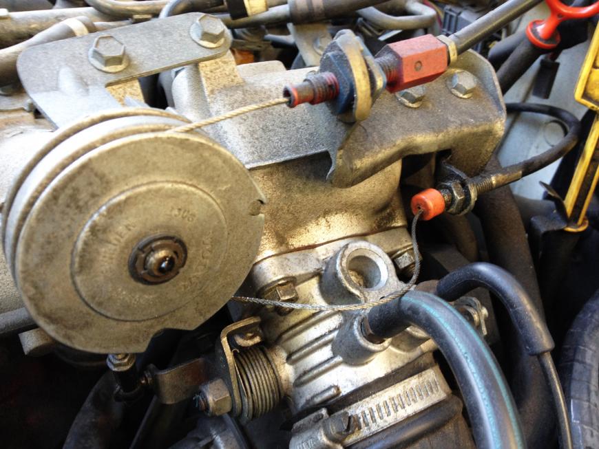

Yeah, looks like the kickdown's outta whack (see photos). Think it needs to be replaced or just adjusted?

Old Jan 14, 2014 | 04:53 PM
if its not retracting, its busted at the other end, and needs replacing.

Yeah, that's its at-rest state, not retracting beyond that point. Mechanic's telling me it'll be three hours of work or so and $300-$400 all told. Sound about correct?
Old Jan 14, 2014 | 05:03 PM
yeah, sounds about right. as I said, the other end is in the transmission.

It looks to me like they are not in their place: the throttle cable should go in the right, the kickdown, in the left groove. I can't tell if the kick down is broken bit I doubt it, they usually just stretch. But I'd look into putting them where they supposed be first!
Old Jan 15, 2014 | 10:23 AM
I had my kickdown cable break a few months ago, it looked exactly like that, it wouldnt retract.
