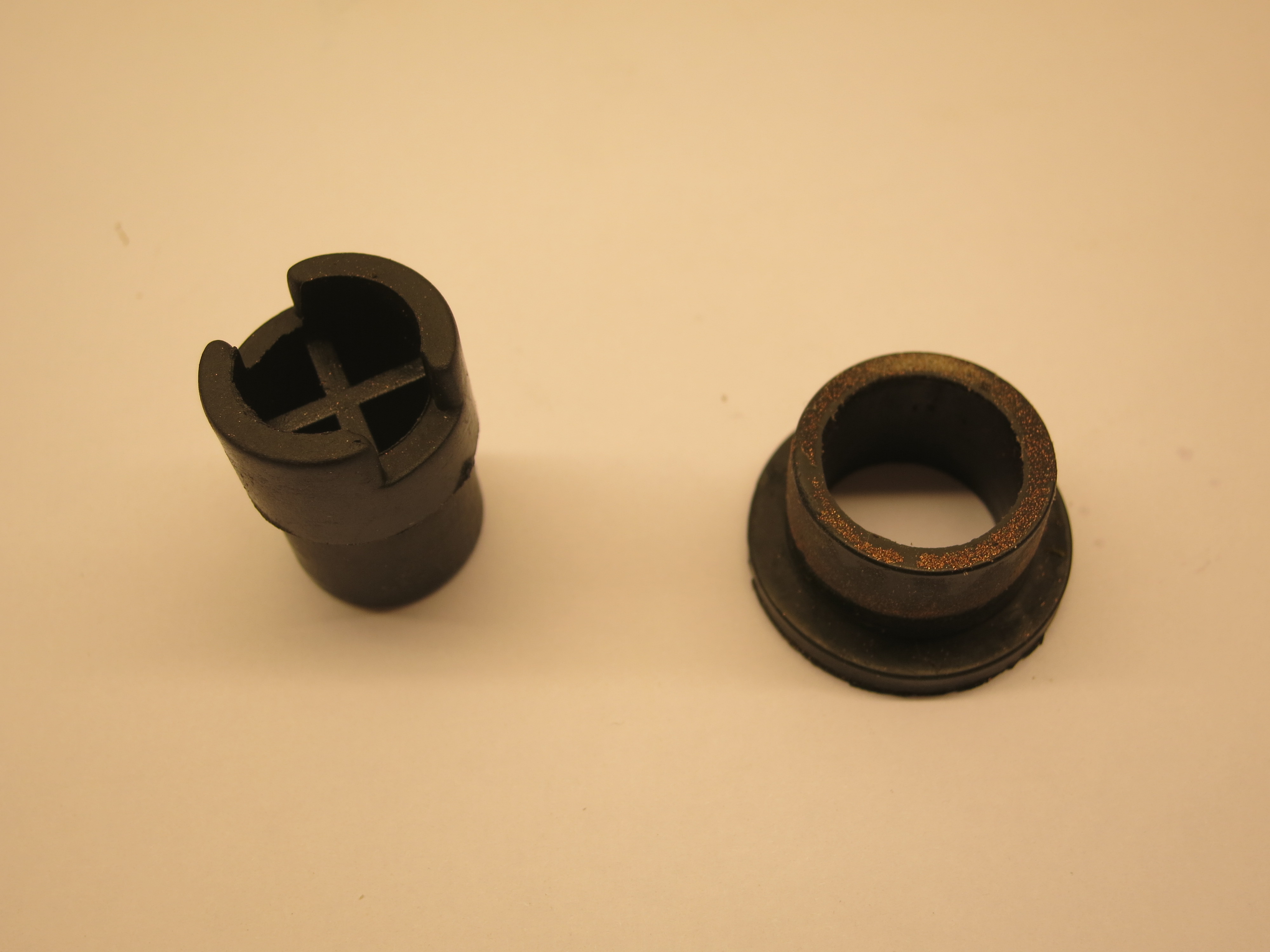

I have a problem with a replacement radiator I bought for my 1995 940 LPT (B230FK). At the rear on the top right hand side of the radiator there was a blanking plug and associated rubber grommet and both popped out as the car was cooling after a long run. I found the plug and grommet on the ground under the car. See attached photos.
The seller of the radiator says "on the original radiator, there should be a strong metal clip that clips onto the tube plate on either side of the radiator, and then goes through the grooves on the blanking plug, and that keeps the plug securely in place. They do not come with the radiator, they are on the original vehicle, and need to be re-used."
I didn't transfer this metal clip - I don't remember seeing it. Can anyone please tell me if it exists?
Many thanks, Matthew
Attached Thumbnails Radiator blanking plug clip on 1995 940LPT?-img_1596.jpg   Radiator blanking plug clip on 1995 940LPT?-img_1597.jpg   Radiator blanking plug clip on 1995 940LPT?-img_1598.jpg

Never seen a clip. The Turbos have a plug, the NAs have a sensor, both are pressure fitted and DO pop out now and then. I just secure them with a strong zip tie through the radiator fins, no problem.

never seen a clip either
common problem that I had with my old 940
I put it back in with some gasket sealer and a zip tie. The grove cut in the top of the plug holds the zip tie neatly. I don't know how well this worked because I cold the car about 1 month later.
also I don't see it in your pic but mine had a bit of a groove to the side, I got an 18" zip tie and it worked fine for me.
