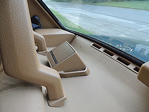

My 1993 240 wagon has OEM Volvo speakers as did my 1991 240 sedan. The door panels have an area that would be cut out if rear door speakers were optioned. On my sedan I replaced the rear door panels that had speakers with door panels that didn't. I then extended the factory wiring and added 1990's vintage flat mount speakers on the rear parcel shelf behind the headrests.
sorry to reply to an old thread I’m hoping you see this. do you know what speaker boxes those are that you used on your rear deck? I’m trying to find them online and can’t for the life of me.
