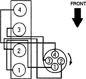

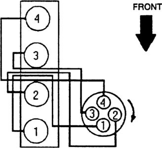

Does it matter what order the spark plug wires are in? Or what order the fuel injector wires are? It’s possible I put those back in a different order than what they were.
Old Dec 4, 2017 | 03:43 PM
yes, the spark plug wires HAVE to be in the right order. fuel injectors, no, all 4 fire together.
Attached Thumbnails Volvo 240 Starter question-261618_0900c1528008c45d_1.jpg
