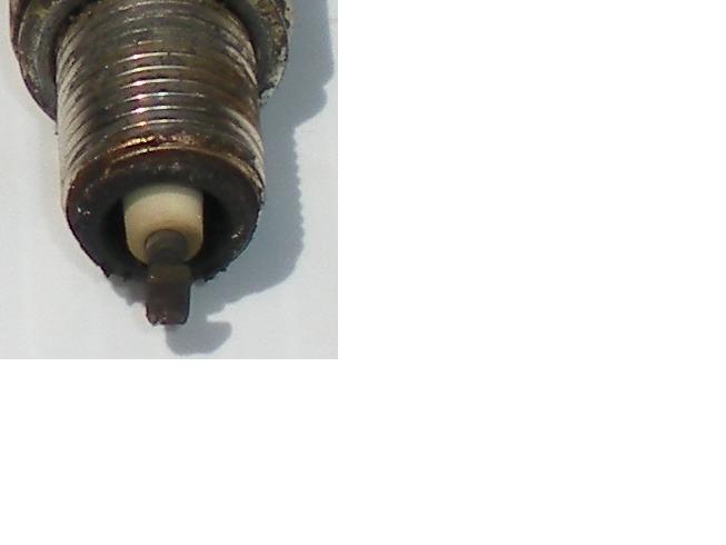

Any comments on these that came out of my new 94 940 na with 125K miles. they were about .045 and the car was running fine
Attached Thumbnails What do plugs tell you?-plugs-posting.jpg   What do plugs tell you?-blow-up-gap..jpg

Kind of hard to see, but they look okay....
http://www.aa1car.com/library/reading_spark_plugs.jpg

thanks, that's the chart I was looking for.... you always have excellent resources

That plug looks normal to me.

For me, it looks a bit black with carbon. It should be brown, IMO. Could drop a number (go one hotter) on the plugs and see how it turns out.

I thought that too and I was having an issue with a slight knock at high speed and seafoam didn't do much so I increased the gas octane rating and it went away. The owners manual says the ideal gas is 91 octane with 87 as the lowest so I'm guessing decades of cheap gas left a legacy for me to fix. I'll waterboard the car this weekend and see what come out the tailpipe. Then maybe I can go back to regular gas.

The black deposits are likely oil. On a redblock, probably valve stem seals when sitting overnight. The plug seems to be heating up and burning them off pretty well, so I would leave them alone.
