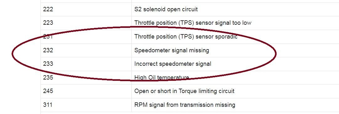

According to: https://www.volvotips.com/service-ma...ir-manual.html
the only code I got was a 2-3-2, which doesn't seem like anything related to the transmission or its electronics.
Old Feb 22, 2022 | 09:18 PM
232 in plug A1 is a speedometer signal problem - related to the trans? I think so. Try reading and clearing all the codes first, then see what comes back. I trust you are checking the codes at terminal A1 also. (not just A2 for ignition/fuel)
