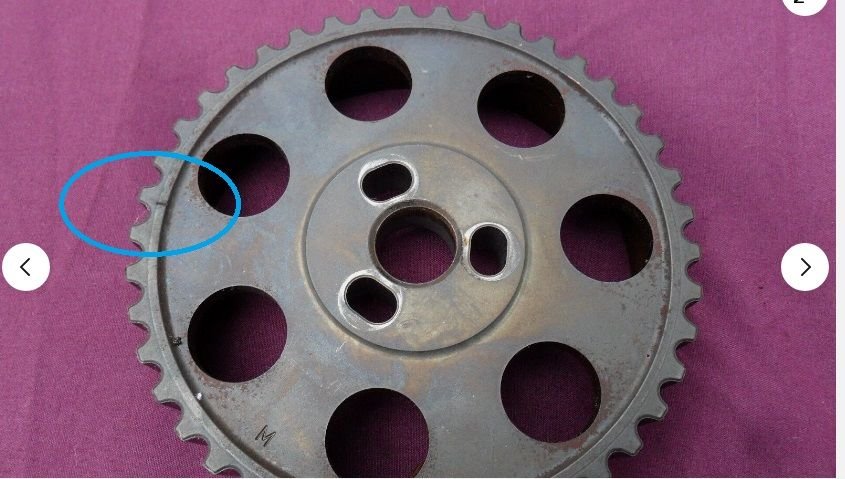

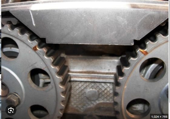

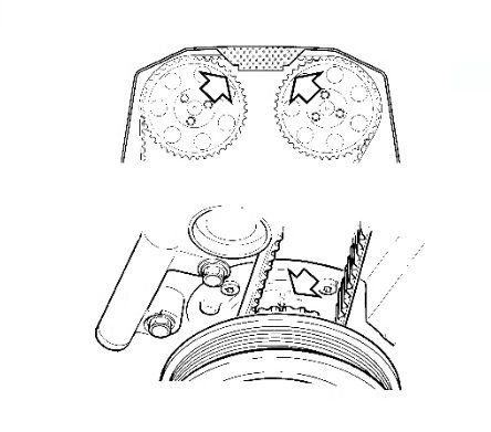

Yes just line up the marks -

- I've done hundreds of those belts myself, my two shops have done many more than that - there are always marks - difficult to see sometimes but they are there.
