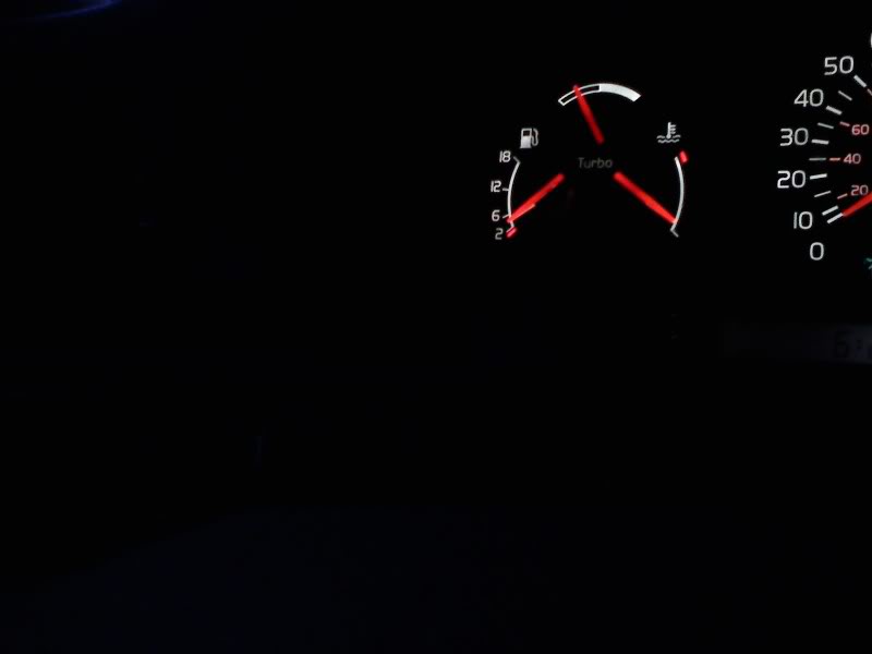

[quote name='lengendsecko87' date='Mar 16 2009, 12:27 AM' post='102712']
Finally
[/quote]
Here are some pictures of mine. As you can see, a lot of my instruments are not lighting up and my radio isn't even lighting up.

I thought all your lights were out, but I can see the major ones are on. Maybe individual bulbs needed replacing and when you undid come dash parts, they may have reached life. Some bulbs are loose; poor manufacturing.
As to the radio, there are tiny bulbs behind the front panel. They too are known to go bad but maybe not all of them at once. However, the LCD is on so you could either try a known good unit or try new bulbs. I believe Honda dealer has the right bulbs. See what others have to say.
JPN

This is a little bit off topic but I like how bright your instrument cluster looks in that one picture up there. Did you just put a white LED light in there to make it look that bright?
Old Mar 25, 2009 | 01:34 AM
Legendsecko87's Avatar
Joined: Feb 2009
Posts: 774
That was actually with the camera. It was a camera phone. Anyways, I did put some white LEDs inside the dash and things, although it turned things blue .
