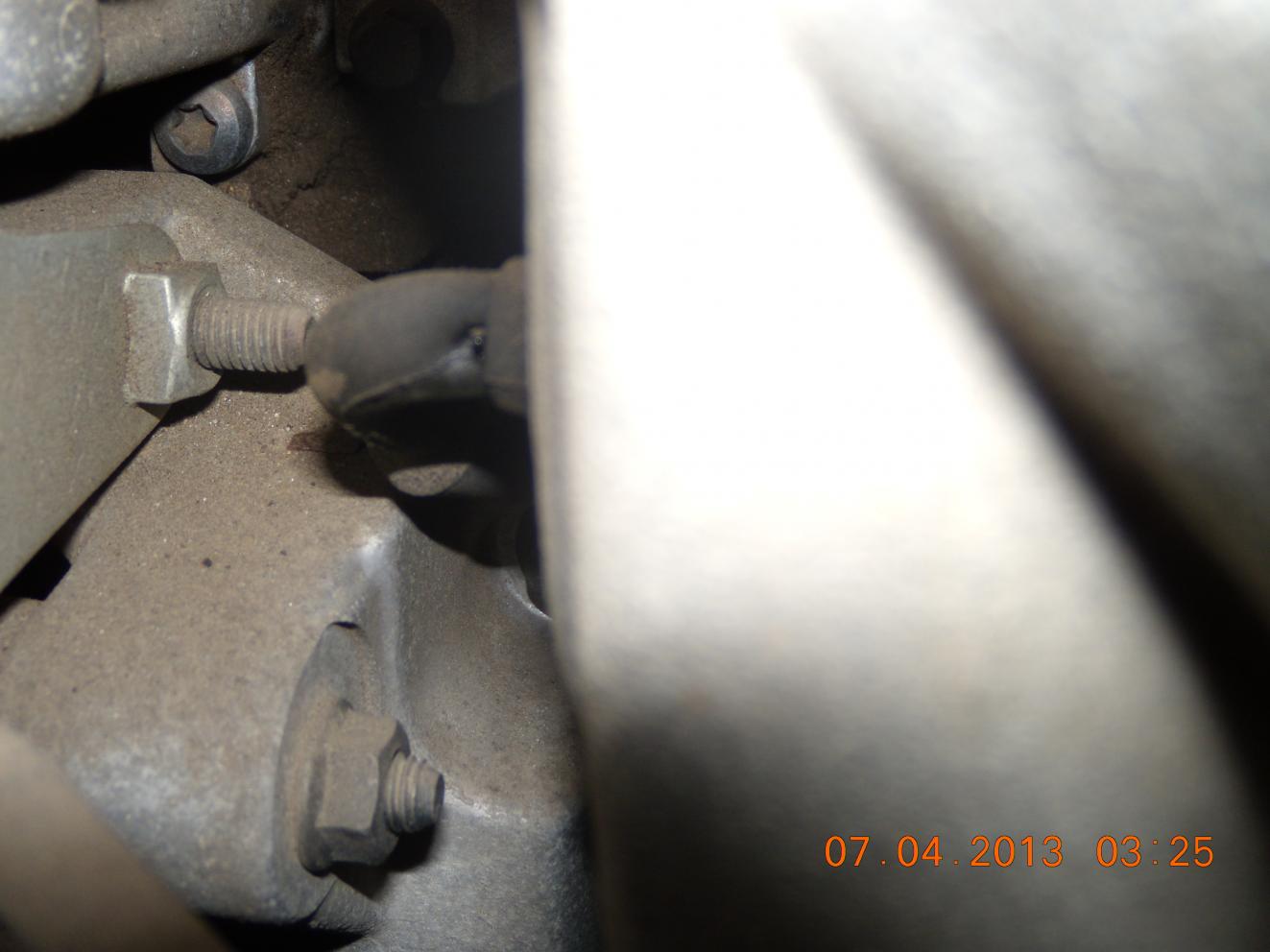

Thanks sooo much rspi!!!!!!!!
Check out the vac hose after that and look at the pic!!! Huge gaping hole in it
Bet that is why Im getting my P0172
Anyways thanks again, now I can fix the problem

You are welcome. Hope it does the trick.

Replaced the part and passed CA smog with flying colors. $5 repair in total!!!
