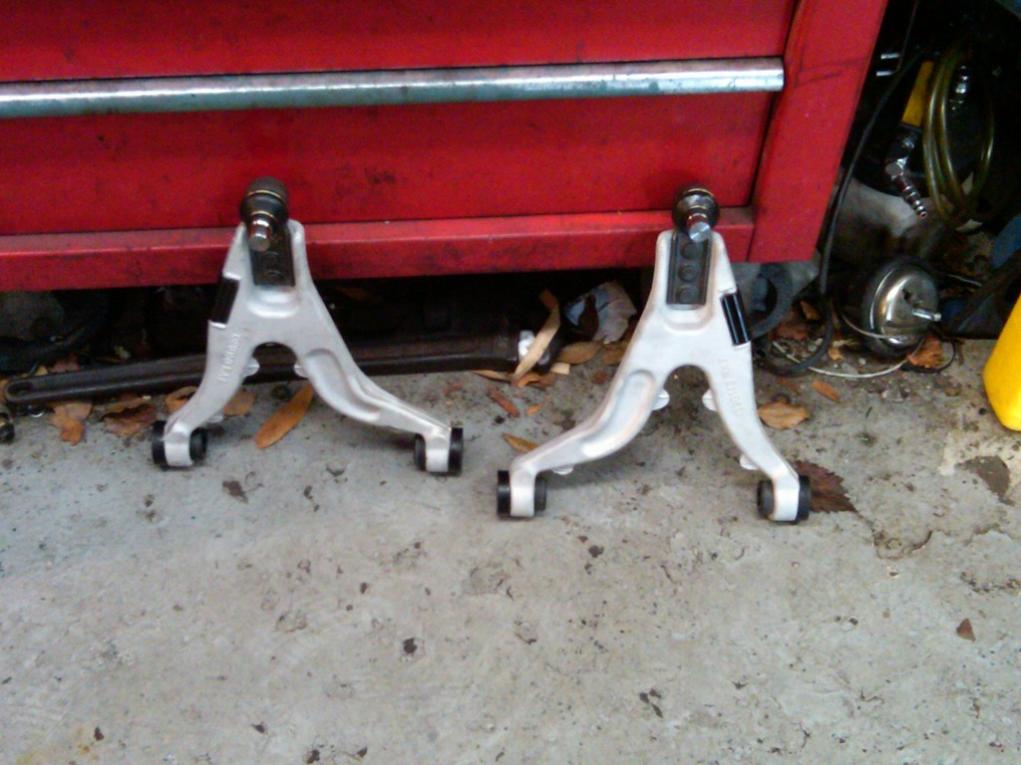

Old Mar 6, 2013 | 05:29 PM
I think the aluminum arms are a bit stronger.
Attached Thumbnails Aluminum control arms on a 95 850-control-arms-aluminum.jpg

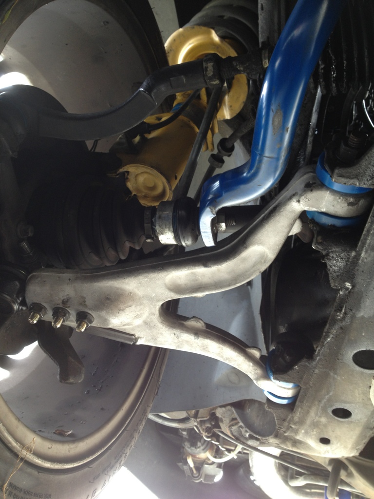

Old Mar 6, 2013 | 08:51 PM
boxpin's Avatar
Joined: May 2009
Posts: 2,702
From: Rocklin, Ca
And have replaceable ball joints.
Here is mine.
