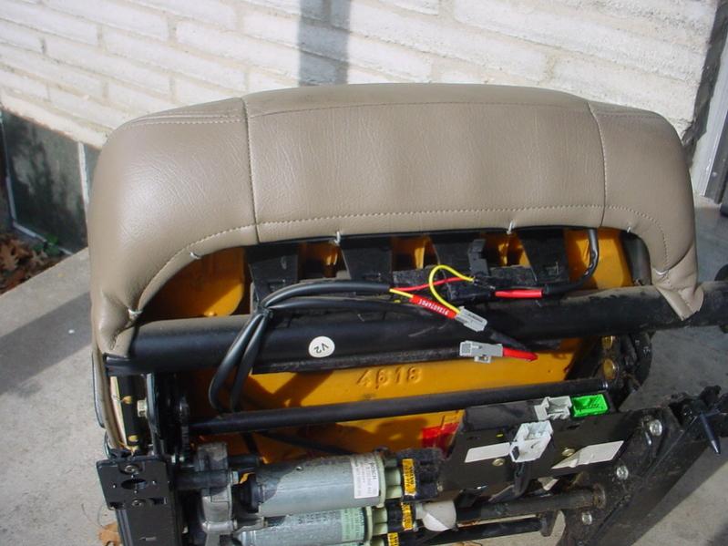

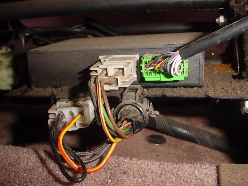

Old Jan 28, 2011 | 01:49 AM
ibified's Avatar
Joined: May 2010
Posts: 1,712
try heyah!
https://volvoforums.com/forum/volvo-850-16/heated-seats-not-working-fuse-good-27622/ (with pics!)
Hope that helps with your diag.
