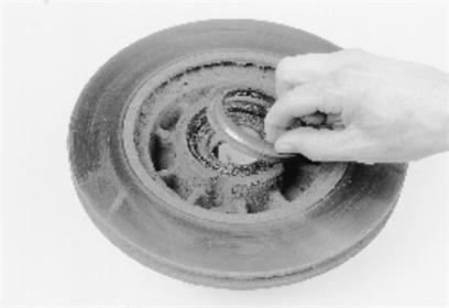

Old Oct 2, 2012 | 03:24 PM
  #25
There isn't an inner seal on an 850's brakes. I was just making a comparison to how you would install the seal if you had worked on an older vehicle and you were doing the brakes and packing the bearings. Since we have a Hub Assembly the inner seal is part of that assembly and is not serviced separately. If you had done brakes on an older vehicle with tapered bearings the way the seal is replaced would be similar to how that transmission output seal in installed.
It's nice if you can find a driver that covers the seal and drives it in but I've normally just set them in place and lightly gone around the circumference tapping it in with two or three rotations. Smaller hammer, light taps as the seal doesn't have much structural strength and a sharp blow could dent it and render it worthless.
If you have room you can also use a chisel to lay across it (tangent not diameter) where you are going to hit it to spread the striking force over a larger area. Once you've done one or two you get the feel, they really aren't that hard to do.
