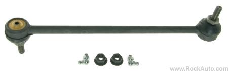

The stock sway bar has molded on bushings and my understanding of doing an upgrade is you need to cut or burn them off. It's hard to imagine one going bad but the cars are getting close to 20 years old so .....
It's more likely the sway bar link is loose, worn out or broke. They get the most work and fail every so many years. Up north here they tend to get weak from rust and snap in half.
I bought Moog sway bar links but they don't have the grease zerk. They are sealed ends.
I bought a set of energy suspension greaseable sway bar bushings but haven't taken the time to remove the old bushings yet.

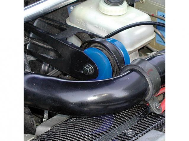

FCP and IPD sell both the replacement and improved mount. I like the
polyurethane one but different people have their own opinions.
