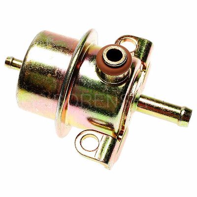

Second, take vacuum line off the fuel pressure regulator and see or smell if there is any gas in the line or coming from the nipple on the regulator. There should be no gas present. If the diaphragm in the regulator starts to leak the engines vacuum will suck raw gas into the engine driving it rich.

I will check the FPR as you mentioned.

I will check the FPR, and also I will do the o2 test I read about on ipd's website.

In addition you should ck the fuel pressure at the rail; FPR could be bad (even w/o the diaphragm leaking) and cause excessive pressure, making mixture rich, etc..

The fuel pressure regulator itself shouldn't (shouldn't) be able to bump up the pressure that much to cause this problem. I'm running a different regulator that is 13psi over stock and my mileage didn't suffer. I did it for when I up the turbo and injectors (blues!!).
If the pressure rises the computer should just trim down the injector pulse to maintain the proper balance.
BUT ...... checking the pressure wouldn't be a bad idea if you can get your hands on a gauge without having to buy it
I know the stock pump in an 850 can go up around 80-90psi as that is its rated maximum. I just haven't seen a regulator do that. Usually they go bad by getting weak and dropping pressure below the operational minimum causing a stumble or higher speed lack of power and finally when they really go bad a no start.
