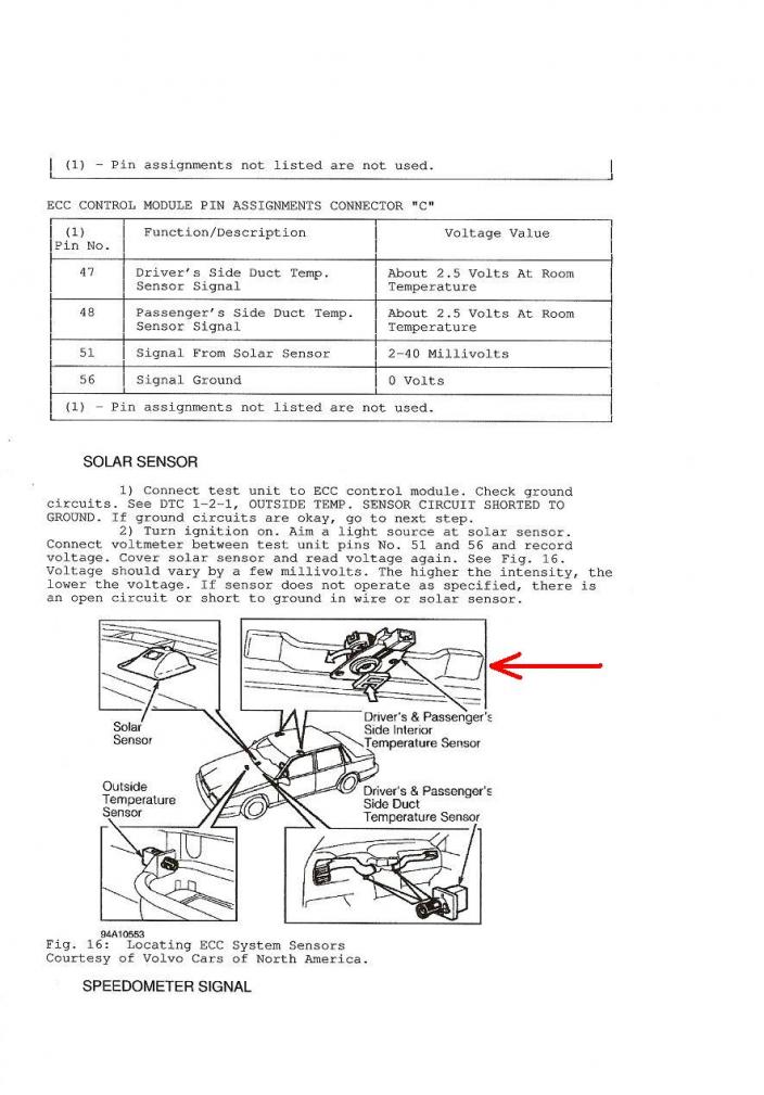

From: Rocklin, Ca
Hey, what does that 'Solar Sensor' do in the picture?
