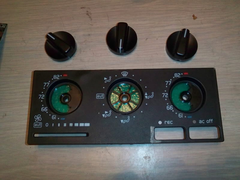

ECC (electronic climate control) or MCC? If not sure, post pic of the control panel.
Old Dec 10, 2013 | 12:38 AM
If it has numbered fan positions it's MCC (Manual).
If in doubt try gently moving the ign key forward and backward when you're having a no blower situation.
Attached Thumbnails Blower motor either works or doesn't work-heat-ac-mcc-panel.jpg   Blower motor either works or doesn't work-heat-ac-ecc-panel.jpg

It's a ECC and the REC and AC off lights flash for awhile after I start the car. Thanks.
Old Dec 10, 2013 | 05:47 PM

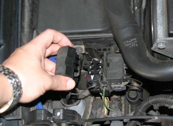

The lights are blinking to tell you there is a problem in the system. Same as a check engine light being on. You need to read the codes to find out what's wrong.
http://www.matthewsvolvosite.com/for...hp?f=2&t=24944
Attached Thumbnails Blower motor either works or doesn't work-obdi-diag-panel-2.jpg   Blower motor either works or doesn't work-obdi-diag-panel-5.jpg
