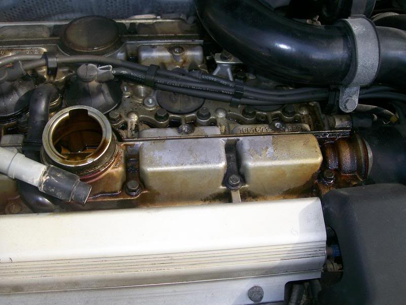

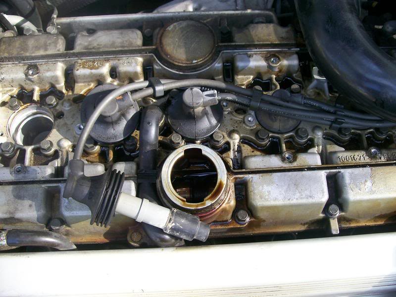

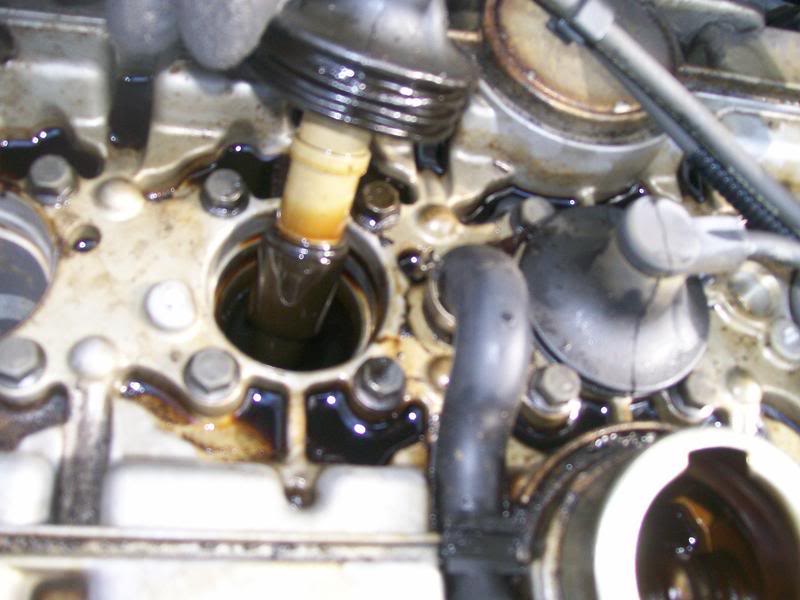

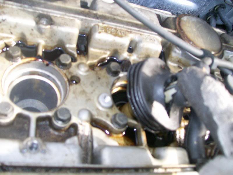

I know this is a bad thing but I'm not sure exactly how bad. I took off my plug cover and saw oil all over the place. I started to trace the culprit and found that the #2 (from left to right) plug was filled with oil. THe boot on the wire was torn as well. I changed the plugs in the rest of the cylinders and left this one alone.
What is th eproblem? Valve cover gasket...or worse?

I'd say maybe the oil cap gasket, get a new cap, they're cheap. How was the car running before you pulled the plugs?

I bet $100 your PCV system is clogged. This happened to my car too, also with plug#2. The oil is being sprayed from the oil filler cap. I don't think changing the oil cap gasket will fix the problem. You have an internal pressure problem, and it is being relieved though the oil cap. I unclogged my PCV and I don't have that problem any more.
