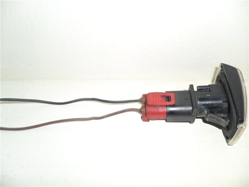

Ok, read the tutorial... seems easy enough...
...except it says...
With both ends of the harness in place, you can now concentrate on the wiring. Pull a few inches of wire out of the loom that connects to the front turn signal. There should be three wires. Which two wires you splice depends on when you wish the lights to turn on.
And then it gives the wires that you'll want to use if you want them on as sidemarkers and blinkers or just blinkers... it says to expect "green and black" or "green and white".
Ok, I haven't checked the color of the wires in the car, but the wires from the lights I'm trying to install are black and brown.
So... if they are green and black, or green and white in the car.... is it safe to assume that I'll just go, black to black, or black to white?
Thanks.

Us a test light and find the wires you need to use.
I recommend you use them as turn signals. I have seen alot setup as parking lights. The problem is they melt the lights after a while.

Test light? Probably something you've got rigged up... or a tool of somesort?
Thanks.

It is a tool.http://www.harborfreight.com/automot...ter-30779.html

ok cool, I could use that tool anyway.
How do you use it? You clip the aligator clip to something metal i'm assuming... and then just jab into the wire... it lights up when it detects a current?

That is correct. The clip goes on a good ground.

So when you're in there... what would make a "good ground"?

Since you will be up front use the battery terminal for a ground.
