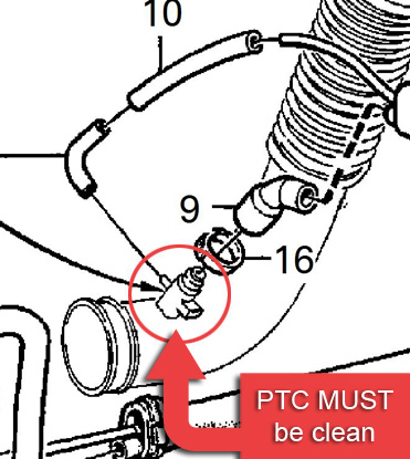

Old May 12, 2013 | 12:23 AM
Try this link: Let me Bing that for you!
http://www.matthewsvolvosite.com/for...ic.php?t=28487
https://volvoforums.com/forum/volvo-...acement-33970/
Attached Thumbnails fire trap-ptc-valve-location-intake-tube.jpg   fire trap-ptc-vac-hose-routing.jpg
