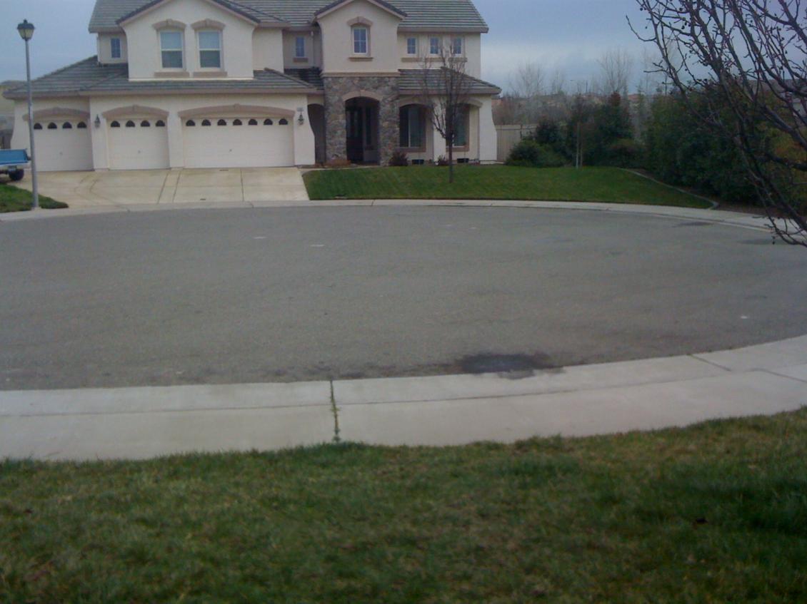

I lived with it for a year. Watch your oil level and try to park in the same spot all the time. The only thing you risk is rubber failure over time. The oil will travel to the rear of the car as you drive. It will coat everything inluding your rear bumper or hatch. Everything rubber will get coated, causing it to swell and get soft. Nothing will happen but it will be a big mess over time. I am so glad I changed out the engine and got rid of the leak. I couldnt park an anyones home I knew because of the mess I left behind. I still have the spot where I parked everyday, it probably wont go away. I have even pressure washed it. From the picture...guess where I parked.
