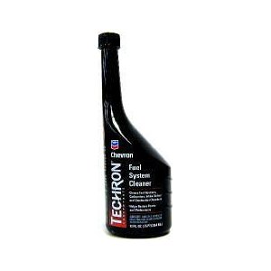

Seafoam is a good general cleaner and if you read the label it says it will do a lot in both the gas or oil. The problem is something like that does a lot of things well but it doesn't do any one thing great. For a fuel injector cleaner I would use Lucas, works great. Check the price of a quart compared to the single use as the quart is a much better buy. Second choice is Chevron with techron. We always argue about which one is better at work
