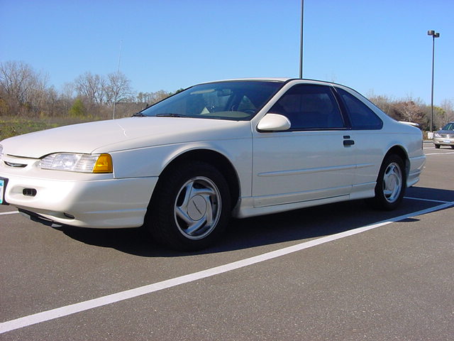

Wow, a fellow 95 SC owner.. here's mine!
Old Jun 16, 2013 | 12:52 AM
Oh no , , , it's a trend !! Pearl White.
