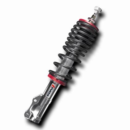

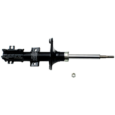

Originally Posted by jeffintampa
I don't have the money for Billys or Konis and even the OEM Sachs are up there. I can get Monroes or Gabrielles for 1/3 or 1/2 the cost. The question is will these cheaper parts give me any change in the way the car sits? I read somewhere Monroes will raise the front about 1/2"(?) Performance is not the issue here, just safety and cosmetics. So basically will these domestic parts be OK? Tell me, what would you do?
New, standard struts, any struts will meet your safety and cosmetics requirements.
If you toss in the less expensive Monroe (I have a set but aren't on yet) or Gabriel the height shouldn't change as they are designed to OEM specs. If someone's height changed it was probably because the springs were in really bad condition. Springs are supposed to hold up the vehicle, the shocks and struts just control the bounce. If the unit has enough gas pressure it might push up the vehicle a bit but again it shouldn't be able to push it past where it's supposed to sit.
You might be giving up some ride control compared to spending more but you said you don't have that kind of money. You get what you pay for and if you are happy with a "normal" ride they should be great.
Nice thing is they are a name brand, they are quality and the chances are good you'll get a lifetime warranty on them. Makes a difference if you plan to hang on to your "Money Pit" !!
Having said that there should be someone jumping in saying it's safer to use a shock with better control. I would agree that having a firmer handling vehicle is safer but the choice is in degrees. You might be better off with a worn out suspension and spending the money on a driving class. The question is are YOU good enough to use the extra handling an upgrade might give?
I tend to take freeway ramps with my cruise control still engaged so I'm going to be returning the Monroe struts and getting Bilsteins but I also got a hell of a deal on them and I have a pair of new (yesterday) sport springs to go with the upper plate, spring seat and bumpers I have waiting in the corner.
Like you I'm short on money and that tempers my choices. If I hadn't come across the deal, I'm sure I'd be pushing the Monroe's to the limit and wouldn't know what I was missing and they'd feel great compared to the very, very tired units I have on there now. After all I bought it with one "Volvo" shock sticking through the floor in the back. Volvo was stamped into the shaft and when I bought it I checked with the dealer. No service history since sixty thousand something miles. Scary thing is at 260K it might have been original
