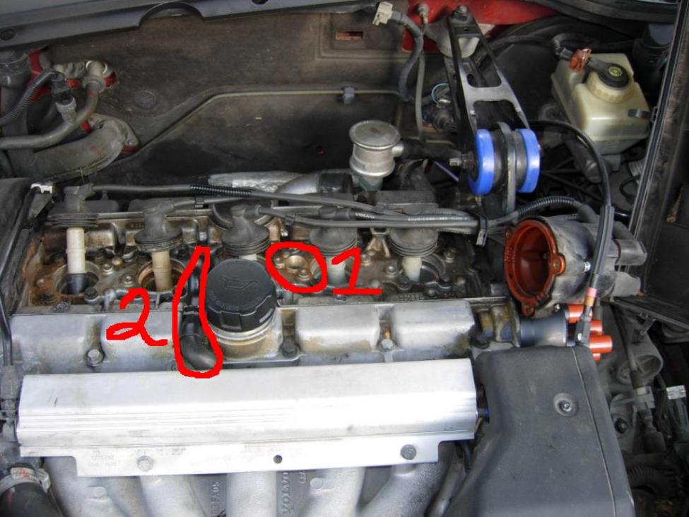

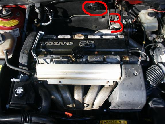

title says it all.
I also tried connecting obd2 reader to car, it wouldnt connect. Then the radiator fan kept running when vehicle was not running and cold. i`m selling the car this week. Just curious as to what these parts are though.

Number 1 is nothing - I just redid my cylinder head and nothing goes there. Number 2 is part of the vent system. Number 3 is the noise maker for your car alarm .
I could not imagine selling my 850. I'm going to keep it 'till I'm dead. Then my kids will fight over it.

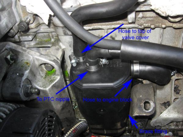

The No. 2 in your photo is the big hose that leads down to the PCV system under the intake. It's called the oil separator box in the first picture.

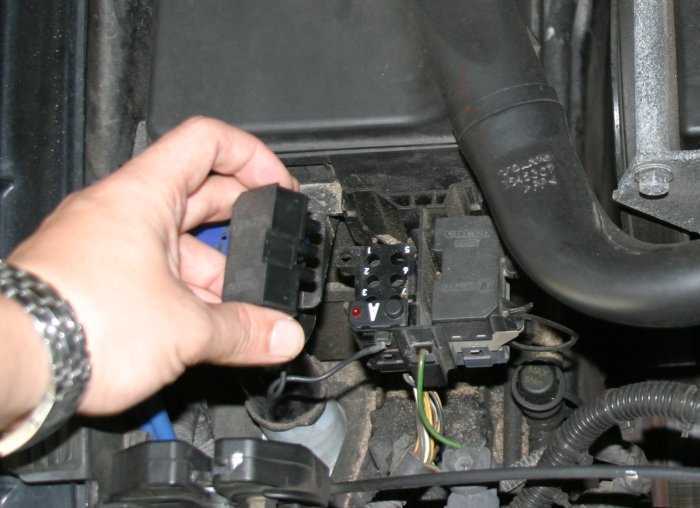

Not seeing anything in the engine bay for obd1. got a pic of location and what it looks like?

Here is a shot of the panel. It's over by the windshield washer reservoir.
I think these are a little overkill but it was handy when I blew a fuse at night. I've swapped out all my fuses to this type.
