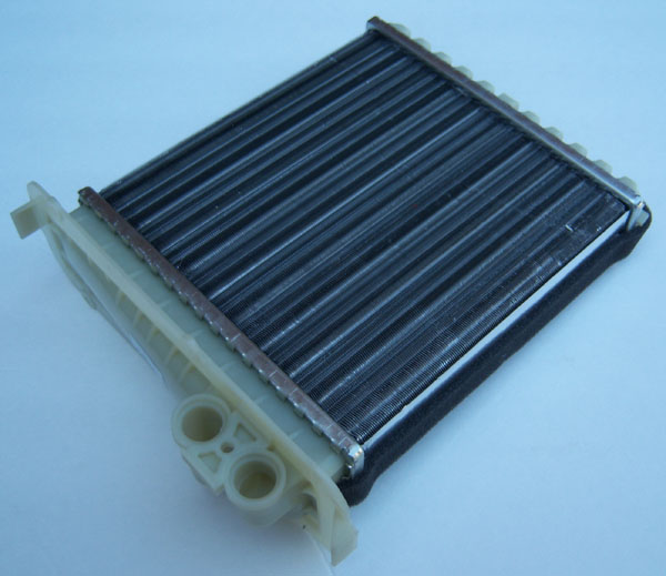

There are a number of complaints of people who did aftermarket heater cores and then smell that burnt smell. It's been attributed to the black foam insulation on the outside of the core used to seal the core to the case. As it heats up it . . . well stinks.
Attached Thumbnails New-b here, few questions-heat-ac-heater-core-crimped.jpg
