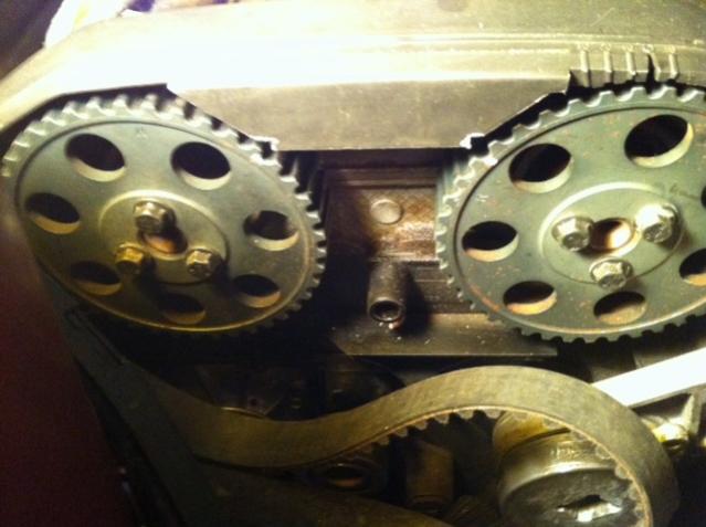

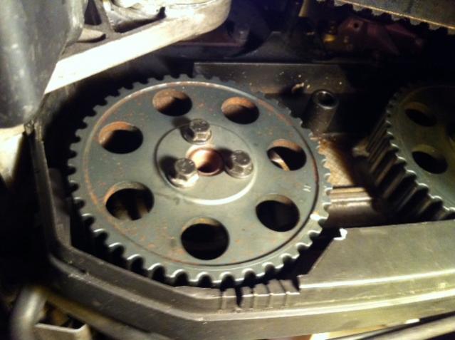

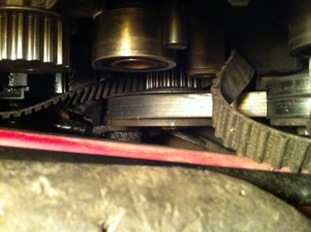

I would have to agree with you HG Carol but I feel you have a lot to offer including your understanding of those who don't have a lot of experience working on specific problems. Aside from of the rude posters, There are many others who truly want to help like yourself. Being an expert means nothing if you don't know how to communicate those who are not experts. One poster wrote that he only had to be nice to those who paid him. Pathetic little Scrooge. In sum, don't go. in one or two sentences, you have helped me understand more than many of the other "experts" offered, as has boxpin.
So onto my Volvo.... I'm wondering is the white marks on the cams are actually the timing marks. They've been there since I bought the car. Maybe they are just for orientation? There is a small "w" or "M" (depending on its position) stamped on each
cam. Other than that, I cant see any other markings. The crank pully has a scored line on its inner and outer edge. No marks on the cog so I had to eyeball it with the raised mark just behind the cog.
Attached Thumbnails New timing belt - No start-photo-1.jpg   New timing belt - No start-photo-2.jpg   New timing belt - No start-photo-4.jpg

OK, Oblidi, one last time for some more of my mis-information. The pictures brought me back (for now) I have to be honest after looking at the pictures and say I'm not sure if those marks are really the marks. That notch on the crank pulley might be the mark. On my 240, that notch is the mark. I don't remember, but I thought the crank gear also had a stamped mark on it that lined up with the notch in the pulley. That might not be true for your car. I also looked at the videos in this thread and I couldn't tell from that either where exactly the mark is. All of the pictures show a painted line. I want to see an etched line or notch on the gear. You should wait to see what ES6T or boxpin have to say. If the notch on the pulley really is the mark, then you need to paint marks on the gear so you can absolutely get it lined up when you put the belt on. It is more difficult to see if it lines up when the belt is on. You need to line it up with the mark on the block EXACTLY and not be off by even a single tooth. Close isn't good enough, it must be exact.
Those white marks on the cam gears might also be the cam marks, but I think there should be a notch or groove in the face of the gear like the video and the pictures on this thread. I doubt that W is it. Wait to see what ES6T and boxbin have to say. Maybe the painted dot is covering the groove. It should look like the pictures. Can you scrape the paint a little and see if there's a notch under it? When I fixed my friend's 850 years ago, I had to wipe the gear really clean with a rag to find the thin line notch etched into the gear. That last picture of the crank doesn't show anything other than the notch on the pulley, on my 240, I would have removed all of the belts. I need to see that the crank gear is clearly lined up.

The white marks are not necessarily the marks. At one time when someone was replacing the belt, they put those marks there. Now, if they put the paint on the factory marks, then they are the correct marks. Your best bet is to take the paint off with some carb cleaner and look for the actual marks, as posted by boxpin.
The crank mark is on the gear and also on the flange behind the pulley. It makes it a lot easier to see if you remove the pulley.
The M on the cam gears is irrelevant.

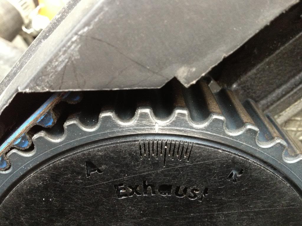

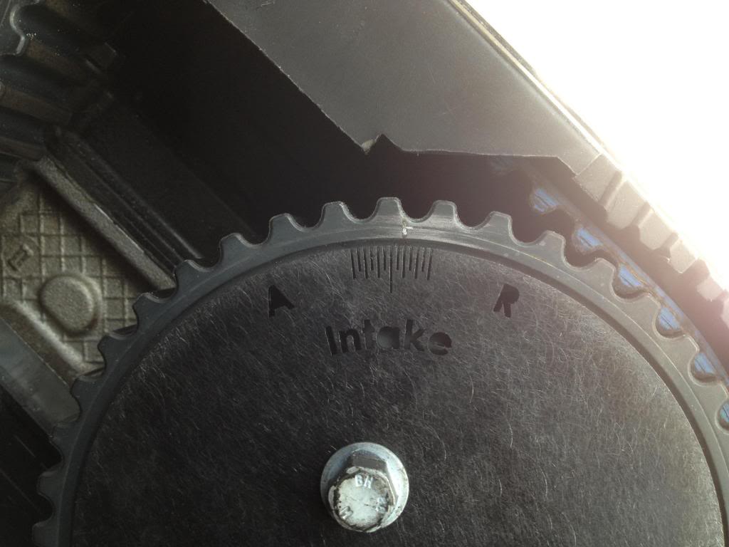

Notches, notches, notches. I am using a cam timing wheel to advance and retard my cam timing but you get the jist.
