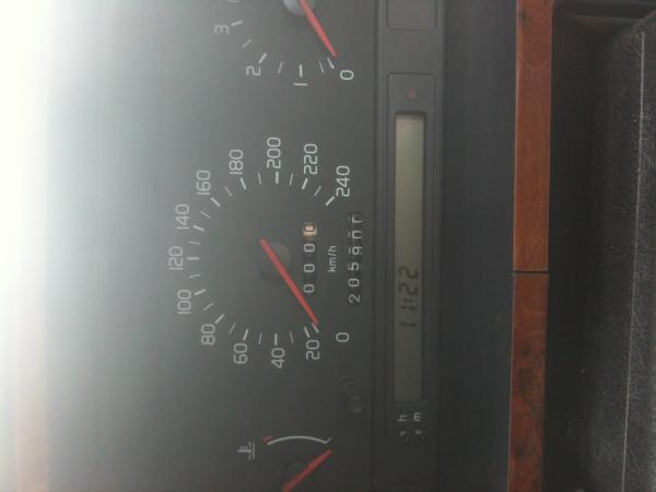

I was about 200km into a 2 week holiday when mine stopped......it took me about 50km to realise that is had stopped clicking over. I have a touch of OCD and it annoys me because the first three numbers are all lined up, but the last three are only halfway. I have to have it fixed!
Attached Thumbnails Odometer motor broken ?-brick850-100609-albums-brick850-1732-picture-img-0240-5736.jpg
Have this image in mind when you view a dashboard photo of a Volvo that "has only 150k miles," or "the odometer just broke." Some sellers will not be upfront with that information.
