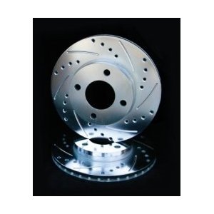

Only thing I can suggest is you might try having them frozen (liquid nitrogen). It changes the structure of the metal and makes them as close to bulletproof as possible. A lot of customers who plow snow or do a lot of heavy trailer towing swear by it.
But never buy the cheapest ones if you can avoid them. They just wear out that much sooner.
Cryogenic treatment utilizes liquid nitrogen to bring the temperature of your racing parts down to -300°F. The parts are then kept at this temperature for 24 hours. This relieves the residual stresses and produces a more consistent and uniform material. The benefits of this process are increased part life, less wear, and improved performance. The most popular applications in motor sports include:
Brake Rotors: Rotors experience several significant improvements. They will warp less and dissipate heat better. The change in the microstructure of the rotor will allow an increase in pad to rotor contact, an increase in lifetime, and a higher resistance to cracking. Now, your brakes will last longer and perform better while improving safety.
