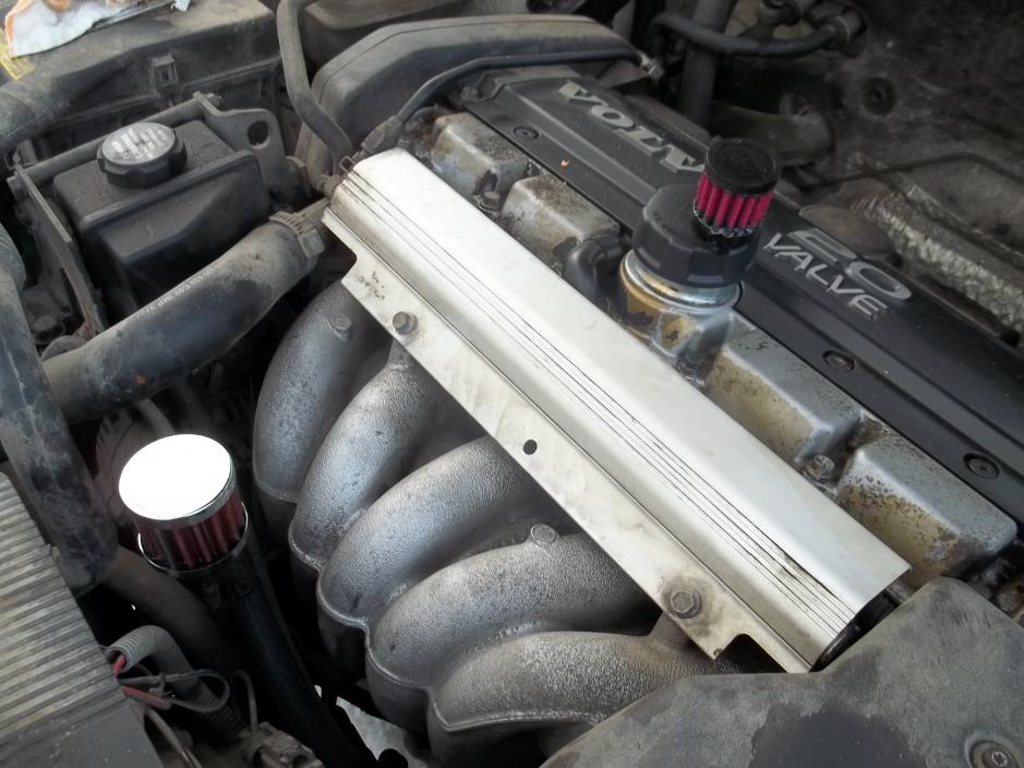

What I am worried about -- and sorry for the lengthy long winded rant here -- is whether or not my current temporary venting system is adequate.
I thought I was being clever so I picked up a spare oil cap and a couple of those breath filters. However I didn't realize -- even though they are washable -- they they would get coated with oil. So I am kind of wondering if I would be better off just with a rag over the dipstick port. But my dipstick just broke anyway and i have a new one coming. For now I have to use a small visegrip and the old dipstick to check oil.
I guess I do not understand just how much pressure it would take to blow my RMS. Anyway it just so happens that a 5/8 push on breather snugly wraps the top of my dipstick port. I drilled a 5/16 port in a spare oil cap I purchased, which originally I was going to drill a 1/2 hole through but then realized that any bigger than 5/16 would mess up the underside locking bar on the oil cap.
So here I am with a 5/16 "push in" breather which I need a silicone grommet for. Then I realized that the hood may not even close over any more added height to my engine oil cap then this smaller breather. Then I started wondering if these breathers are more designed with intake air in mind.
As you can see I am feeling very compulsive about this whole PCV thing right now. I do not understand just how much pressure is normal operating pressure within the engine and whether my current temporary double breather modification is sufficient to keep me running without danger of further trouble while I order my PCV kit, gather my tools, and wait for a warm spring day...

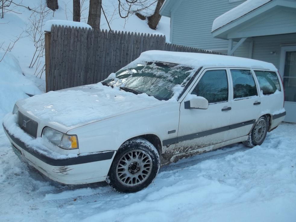

Here's my Baby you all deserve to see her...
Attached Thumbnails Replaced Rear Cam seal but now worried about PCV pressure...-100_0823.jpg   Replaced Rear Cam seal but now worried about PCV pressure...-100_0827.jpg

I'm not surprised. I was hoping you would mention a wine cork for your dipstick with small holes. :P lol I've seen it all, and heard it all. Now that you tried to fix the weakest point, the pressure is going to find itself on another weakest point. The PCV system should of been performed first. I had someone drive theirs without the oil cap. :P
