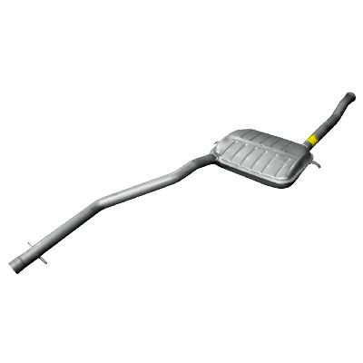

I've never had any luck trying to patch a muffler with the "kits" they offer at the auto parts stores. I'm with VTBricked, replace the muffler. You don't necessarily need to go back with a stock one although that's the easiest but cutting the muffler out will be easier than trying to patch it only to end up having it fail and being back in the same position fairly soon.

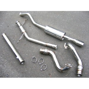

Then again, if you have an extra 400 bucks laying around now would be the best excuse to go with the OBX stainless steel exhaust !!

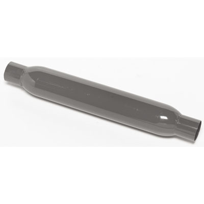

Well, if you do some fitting you can get a couple adapters at any auto parts store and either a glasspack or original style (not Volvo) muffler and fit that cheap new muffler in place.
