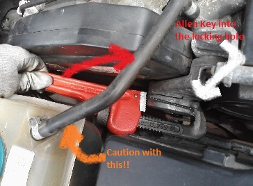

Like I said before I just bought this 850 SW non-turbo and I didn't realize that the compressor pulley was locked because the car ran without any problems and the serpentine belt didn't make any sound ( I don't know why) the thing is I was trying to get a short serpentine to bypass the compressor and here are the photos.
Things you need:
1. 1/8 Allen key
2. 14'' pipe wrench
3. long thin stick (can be an arrow or a coat hanger)
4. Vice grip and 3 quarters(just in case you release the tensioner and it goes all the way you cannot grab it back with the pipe wrench, that's a little trick to move it but don't go too hard because you'll bend the quarters )
The thing was that I took out the old serpentine and I don't know what I did but I unlocked the compressor ( It still doesn't work but the pulley run ) so I returned the new one and get my money back.
I think this is a good idea just in case you are in a hurry and you don't have the right tools like me... ( this is only to take you out of trouble so you can scratch parts with those tools)
I hope you understand me 'cuz I'm not a english speaker..... Thanks!
Attached Thumbnails Serpentine change (plumber technology)-p08-19-12_13-44.jpg   Serpentine change (plumber technology)-2.jpg   Serpentine change (plumber technology)-p08-19-12_12-24%5B4%5D.jpg

I like the solution, however I dont inderstand what the stick and quarters are for?
The stick is to help you to set the route of the belt.
The vice grip(use a small one is easy to the limited space) and the quarters are just in case you release the tensioner without the belt, the tensioner will go all of the way and you cannot grab it with the pipe wrench to take it to the maximum, what you gonna do is put together all the quarters and grab them very strong on the right side, the left side of them will fit the square of the tensioner, you just have to pull a little bit and stop the tensioner with something to grab it better with the wrench ( remember don't go too hard or you're going to bend the quarters)
I see! I wish I knew this trick b4 I went and wedged in a 3/4" drive adapter, lol...
