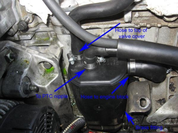

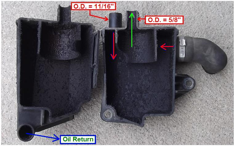

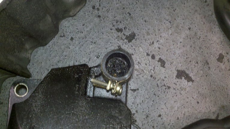

I took it for granted that the PCV black box had some complicated baffling in it and that's why it caused problems. Then I saw one cut open and there's nothing in there really. You want to make sure the bottom port isn't plugged like in the photo.
If you pull the black box and it's ports aren't plugged you can likely re-use it and just replace the old brittle vacuum lines and if it's a turbo clean out the PTC valve some of the lines run to in the intake.
The problems come when that bottom port the black box uses for a drain plugs up. That was another surprise for me as I thought the box just drained back into the block and dropped into the pan. NOPE ... the engineers designed a passage thats cast into the block and mates with a passage that goes into the oil pan.

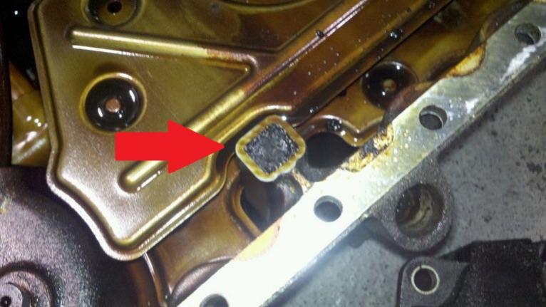

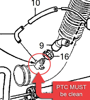

The PTC and a shot of that passage in the oil pan that can possibly plug up and cause the engine to push oil past the seals and smoke come out your dipstick or oil fill.
So the deal is, 150 for a complete PCV kit and if the ports plugged and you don't check it and fix it you just spent 150 for parts that won't work.
