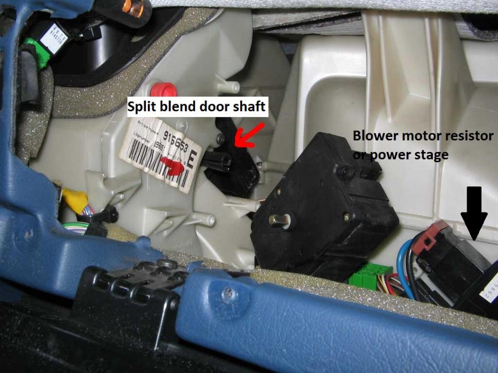

Old Jan 22, 2014 | 09:32 PM
It could be the shaft the motor operates has broken and you're hearing the motor trying to turn the door to it's proper position but just clicking against the shaft.
Attached Thumbnails sound from vents/dash area-heat-ac-damper-motor-broken.jpg   sound from vents/dash area-heat-ac-damper-motors.jpg

Thanks guys, I'll look into that video, judging from the pics is seems the recirculation damper motor is it....so much to do in spring :-)
