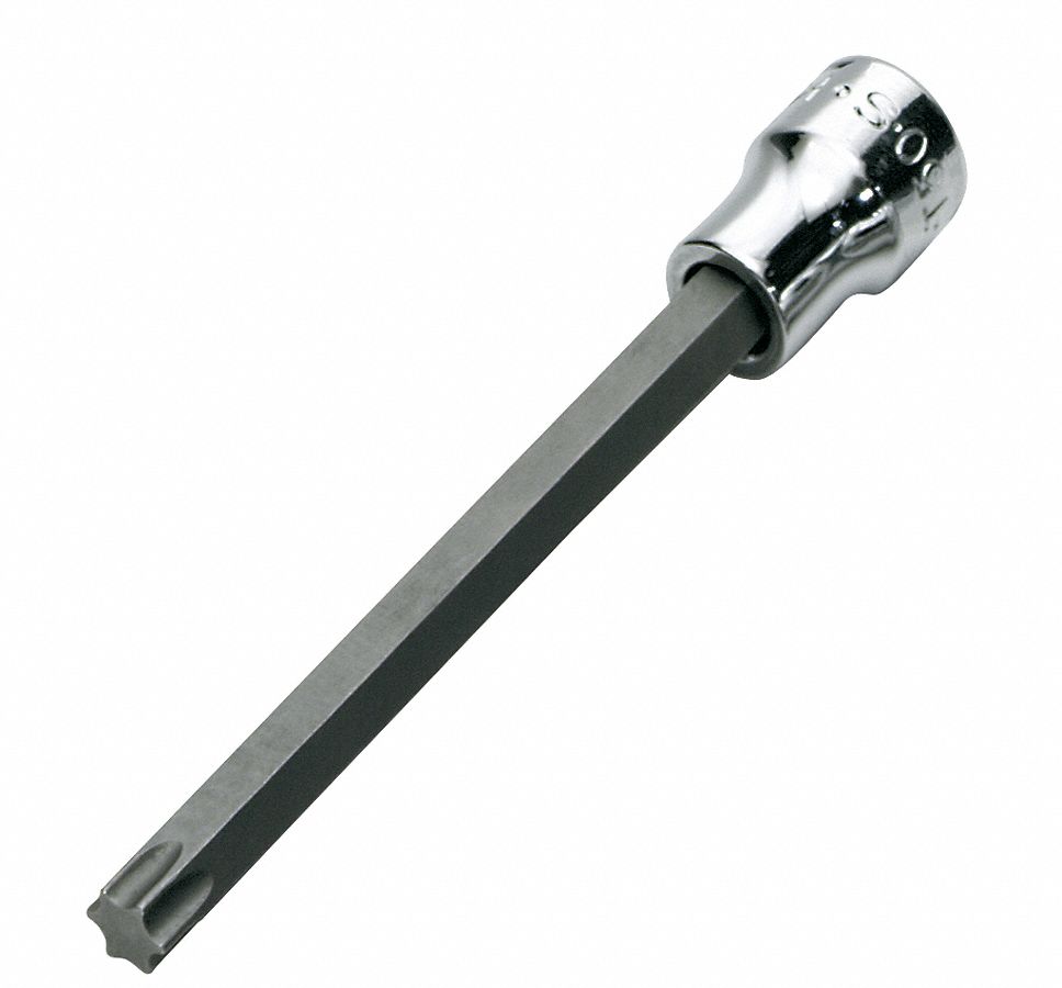

Old Mar 21, 2014 | 07:31 PM
I think this is what ES6T was talking about. I have a set but for the average guy they are a bit overkill. It will allow you to get past the fuel line and straight on the screw.
Old Mar 21, 2014 | 08:56 PM
That'll work. Also, I have seen torque sets like allen sets. They work pretty good also.

They stock the angle set at Sears. I got the screws out without buying it, but I just thought that was a dumb place to use a torx.
that's what I used and rounded the bolt.the bolt was weak anyways. It was stupid for Volvo to use that kind of bolts Imo
