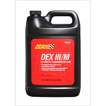

I'm not having any trouble finding it because I use a newer, better fluid in my older GMs that spec DEXRON-IIIŽ. If you notice that registered trademark at the end of the name you will notice you will not find it anywhere for sale. They abbreviate the name because they can't legally call it DEXRON-IIIŽ because it's no longer licensed to be manufactured.
In my volvo I'm using a specific Ford fluid because it firms the shifts and doesn't allow the clutches to slip as much as DEXRON-IIIŽ or Dex/Mercon will.
You didn't buy DEXRON-IIIŽ, they don't make it anymore. That's as clear as I can be. You purchased what is know as "Dex/Merc" and it is backward compatable to DEXRON-IIIŽ but it isn't DEXRON-IIIŽ. If you still have a doubt, read the label Advance puts on it.
  • Formulated for older model Ford and General Motors vehicles
  • Suitable for transmissions requiring MERCONŽ, DEXRON-IŽ, DEXRON-IIŽ and DEXRON-IIIŽ automatic transmission fluid
They are saying it is "suitable" for transmissions that required DEXRON-IIIŽ and those others. They are not saying anywhere on the front or back of the label or on their website it is DEXRON-IIIŽ.
You wanted someone to answer your question who knew transmissions. I know, I'm trying to inform you and I'm using fact. Calling Dex/Merc DEXRON-IIIŽ is like calling a facial tissue a KleenexŽ. It's not exactly accurate but we know what you're saying and it's an accepted noun for an item that does the same function
I do see it's a bit misleading because they call their Dex/Merc "Dex III/M" but like the facial tissue, it still gets the job done and yes you did use the correct fluid and finding out if you did was the main goal in the first place.
The reason the fluid is important is if you used the wrong fluid you could have a second problem and either make the first one worse or have more going one. It's like replacing a bad part with a new bad part. It's new so you trust it and move on everywhere else because it's new so it couldn't be bad. Doesn't happen very often but it can eat you alive in time because you're chasing everything else.
