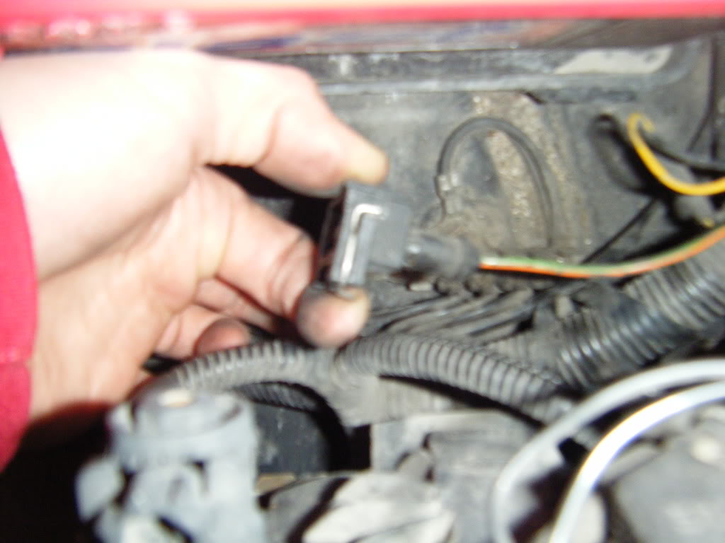

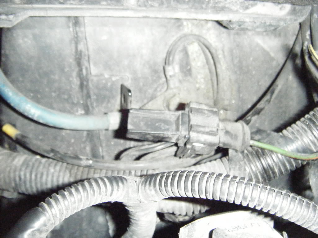

I just read that and ran back down to my car to check. I found a connector that was plugged into a blank. There was only one wire, BUT, it was the same color as the fog power wires: green/orange. The plug that I found on the passenger's side is NOT the fog plug either, wrong color wires: green/gray. I think this is the one I need, I have to run a wire from this each of the fogs I assume (according to that post from boxpin), and from the fogs run the negative and ground it out somewhere (probably on the ground rail by the battery. According to this write up, it says that the harness is behind the battery, if you're standing in front of the car, it's in front of the battery, between the battery and headlight. I took pics. Give me a second.

Hmm. I have thought that has been it but I never guessed. I have always known where that one was, but I thought it was for some other option or something.

It's just the green/orange wires, no ground on it, but just like the thing that boxpin posted, the lamp harness has the ground on it. Legend, that'd be something that could easily be made isn't it? If you solder everything and what not?
Damn, thanks boxpin for that. I think this is it. The guy who I ordered the inside harness from asked if I needed the front harness, I had no idea what he was talking about, but this is what he was referring to. But it sounds like something I can easily make.

If you look RIGHT under where your hand is on the bottom picture there is a row of plugs that you can use for a ground. if not, you can tap into the headlight ground. Go to a hardware store and look for the quick wire splicers.

Yeah, I noticed those, I thought that's what they were. Damn, this is a relief knowing for sure how to wire them in now. The guy that is sending me the harness for the switch confirmed that that is the right plug.

No no no. That isn't a fog light plug, the wires are the wrong color: black and green/gray.
The separate harness that you buy for the front, the "lamp harness" connects to that and then splits into two plugs for the both fog lights, and the ground splices off of this harness. The guy I got my fogs from left the plugs in the fog lights, so I have the plugs and about 6" of wire on the fogs themselves. So I'm just going to make my own harness.
