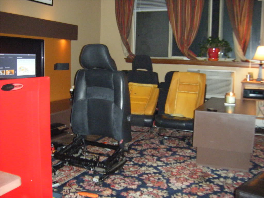

Passenger's side guts going on this frame:
And just cause I think it's funny. Definitely not your average college student studio apartment right here. More like a parts warehouse. lol.
I think you should seriously consider moving up to a BMW or Porsche.

Nice apartment! You def. belong around here with all those parts! Techs garage is the same way! I tell him when looking for parts to see if he has a C30 somewhere in there,lol....

Lol. I have just as many parts in my parking garage too. Another seat, a couple ABS modules, turbo, motor, tranny, gaskets galore, etc etc. Hopefully I'll be able to get this stuff cleared out pretty soon.

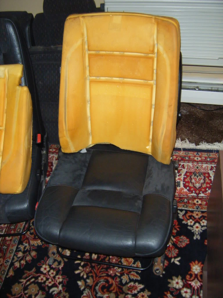

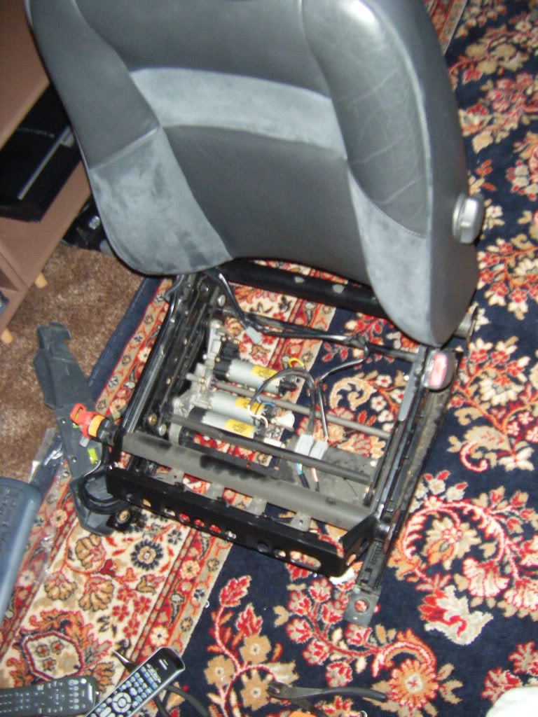

Transformation of the first ever manual S70 T5-SE seat is 1/3 ways done.
SEATS!

Back skin pulled off, foams swapped, now I just need to wait until I have some time to get to Sears and get some hog rings and a hog ring pliers. Otherwise everything fitted right up to the manual seat. I'll have to cut a couple small slices for the tilt **** on the side of the seat, but oh well, gotta do what you gotta do. Post pics tomorrow or sometime.

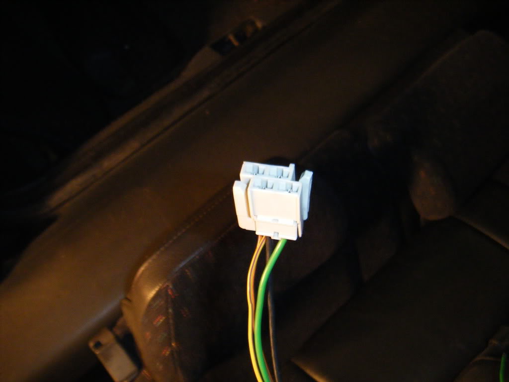

Sorry I was away but the seat itself needs 2 power wires. You can run one and Y it off to 2 wires by the seat.
Old Apr 6, 2010 | 07:34 PM
  #390
gilber33's Avatar
Joined: Apr 2008
Posts: 3,948
From: Milwaukee, WI
There's nowhere to tap a second power wire in. There's only one power wire on the power seat harness.
Old Apr 6, 2010 | 07:38 PM
  #391
tech's Avatar
Joined: Sep 2004
Posts: 36,349
Likes: 46
There should be 2 one constant power adn one that powers up with the ignition.
Old Apr 6, 2010 | 08:58 PM
  #392
gilber33's Avatar
Joined: Apr 2008
Posts: 3,948
From: Milwaukee, WI
Hm. There was only one power wire for me to tap into. All of the other wires were grounds. There was one power wire on the power seat harness and one on the heated seat harness. That'd be it.
Old Apr 6, 2010 | 09:04 PM
  #393
tech's Avatar
Joined: Sep 2004
Posts: 36,349
Likes: 46
The wifes has 2 wires for power and one for ground.
Old Apr 6, 2010 | 10:01 PM
  #394
gilber33's Avatar
Joined: Apr 2008
Posts: 3,948
From: Milwaukee, WI
This is what I have. And after reading the wire diagram for it, the green is power, black is ground, and the two other ones (orange/brown and yellow/violet) go to the computer.
