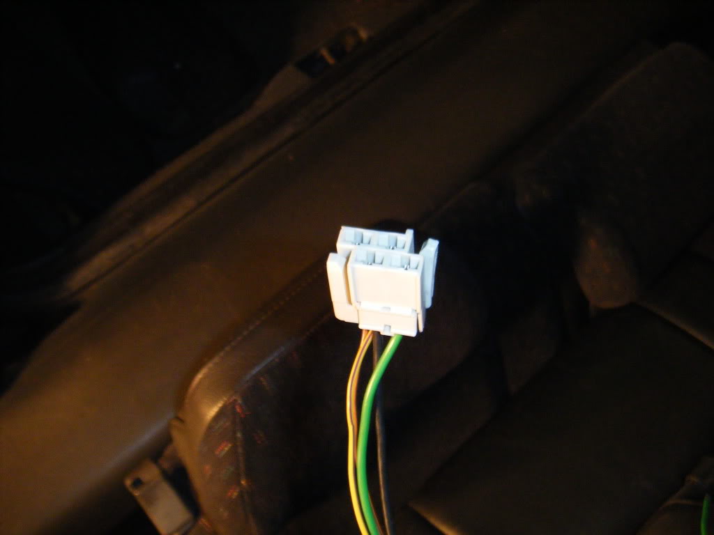

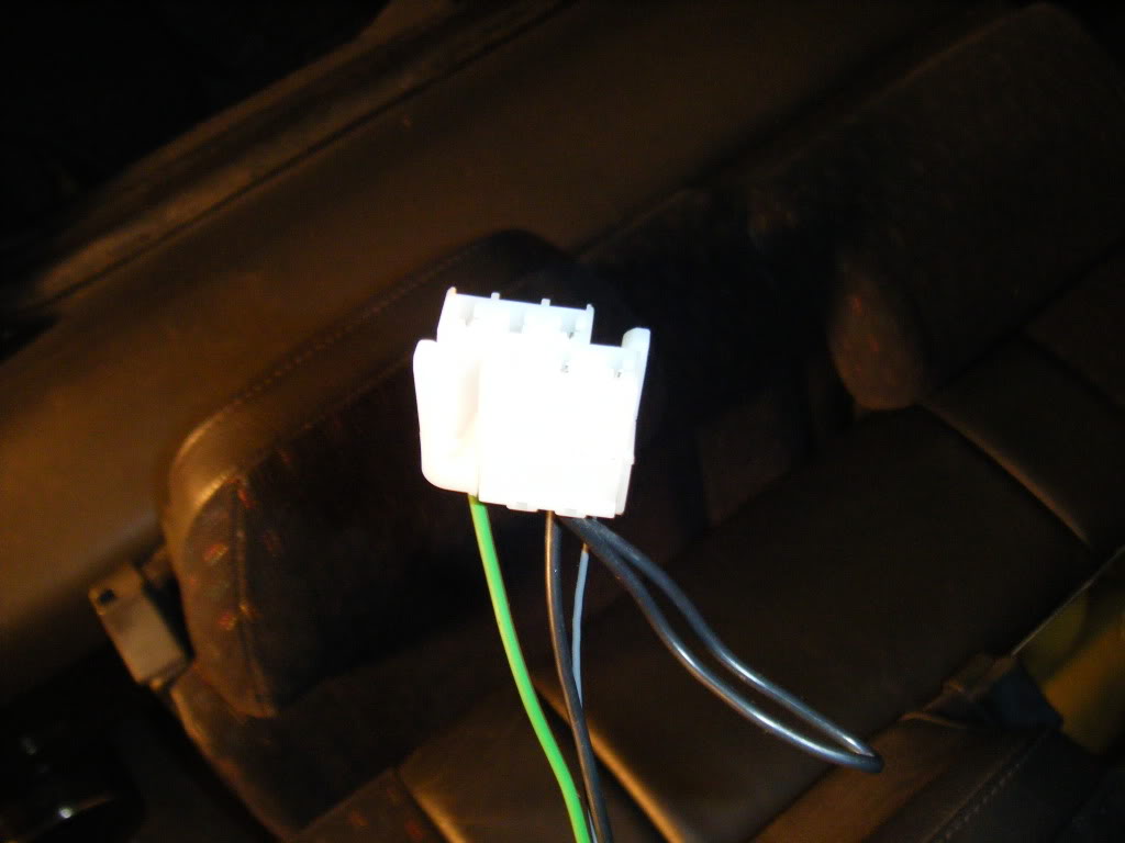

Where's the second one? My passenger seat is manual w/heat. And I'm putting in a power/heat.
This is the heat harness:
And the power seat harness:
So I only have the heated seat harness in the car, I cut the power harness out of my wagon for the connector. I'm thinking the green wire one power harness to the green wire on the heated seat harness, but you're right. That probably isn't a constant 12V. I would need to turn on my heated seats in order to use the power seat.

Well, made up a harness for the powered passenger seat with no luck. I spliced the spare passenger power seat harness I have into the driver side power and ground. That passenger still has no power seat, although the driver's side still works no problem. Anyone have any ideas?

Do you have the 2 power wires connected and the 1 ground?
Old Apr 1, 2010 | 09:44 PM
  #375
gilber33's Avatar
Joined: Apr 2008
Posts: 3,948
From: Milwaukee, WI
This is the harness that plugs into the connector for the power seats. There's only one power wire. I am going to check volts tomorrow to make sure I'm getting 12V at power and ground, if I am, I'm swapping the SE seat onto a manual frame. If I'm not getting 12V, I'll redo the harness, but I doubt that's the issue since the driver's seat still worked after installing the harness (which I did by splicing into the driver's side power harness so there would still be a fuse in the harness)

Cool but like I keep saying you need 2 power wires and one ground to make the seat work. I had the wifes hooked up quick when I installed it. This way I was able to move it into a good position then took the wiring out. I wanted to be able to hook it up and run it under the carpet.
Old Apr 2, 2010 | 06:10 AM
  #378
gilber33's Avatar
Joined: Apr 2008
Posts: 3,948
From: Milwaukee, WI
I need two power sources spliced into the one power wire on the harness?

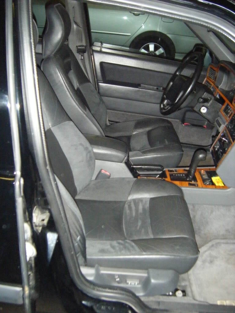

Some pics.
Wheels on with new rubber:
S70 T5 SE seats in

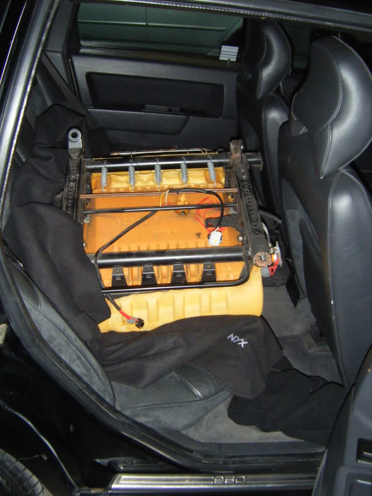

Passenger's side guts going on this frame:

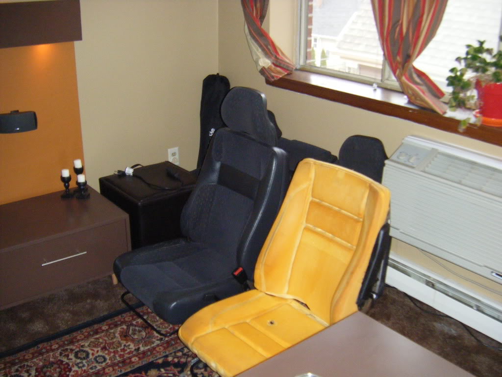

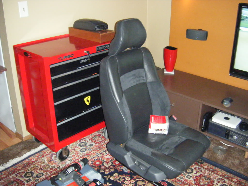

And just cause I think it's funny. Definitely not your average college student studio apartment right here. More like a parts warehouse. lol.
