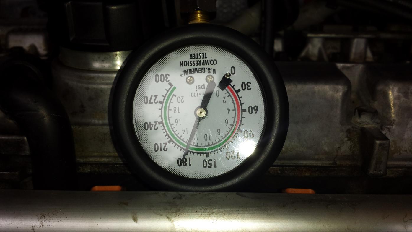

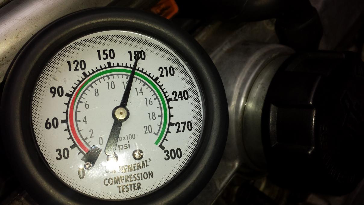

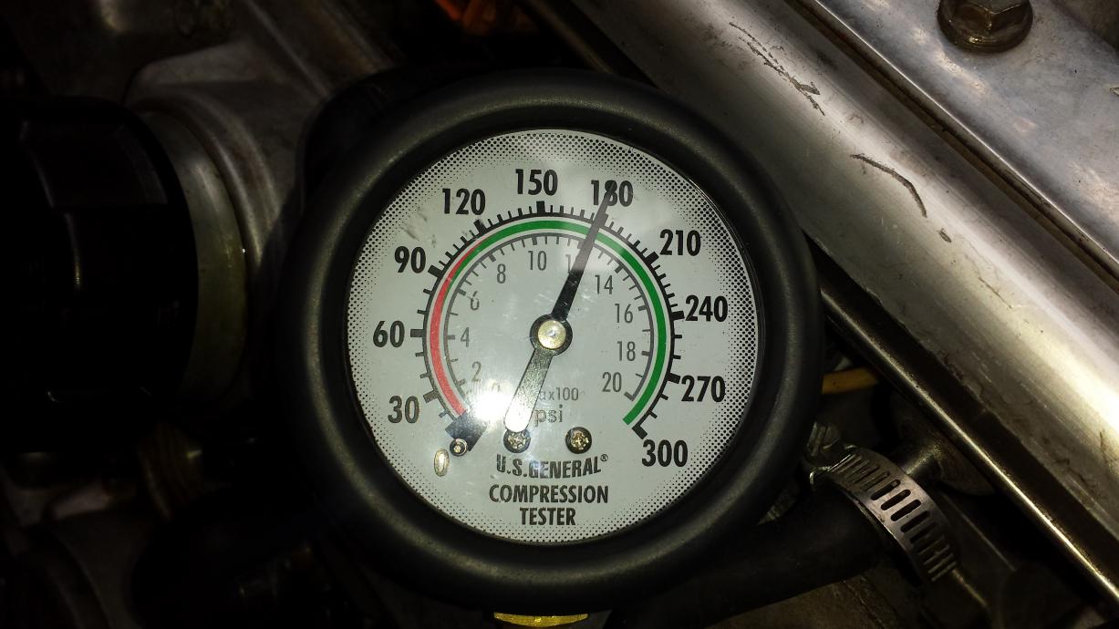

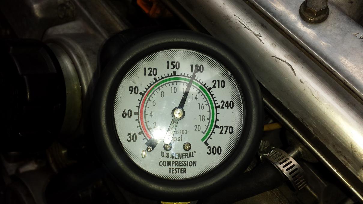

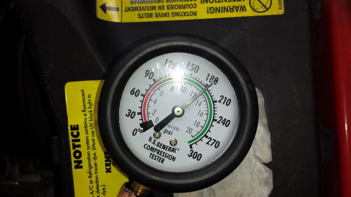

we performed a compression test on all five cylinders. all five readings were above 180 psi the first round, pictures attached. we actually ran the test twice as a result cylinder two and four were closer to 186. Our other R runs great and the pressure reading is in the 170s.

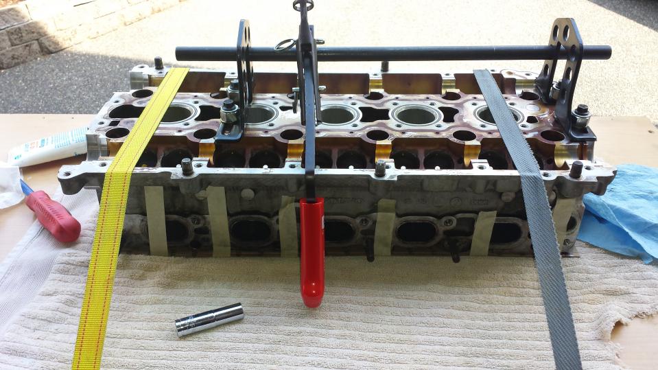

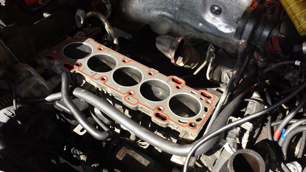

Sorry for the long delay on getting back to you All. I am on mobile the pc still showing server error when I try to get n the forum. Anyway, valve cover is off waiting for the schley 91400A valve spring compressor. I checked the turbo again and no sign of malfunction. It spins freely no shaft play. It was rebuilt buy a shop here in kent wa. Very happy with the service. Among other things the cam shaft sensor plug disintegrated in my hand, cam seal leaking will replace all four anyway. I will upload some puctures as soon as I can log on from the pc. Thank you so much for your patience, advice and time, deeply appreciated. Andrea

Finally back on the forum from a pc. we did rebuilt the head, valves, seals new head gasket, new camshafts seals and sensor, new turbo hoses. checked the turbo again and could not find anything wrong with it. car is running great the blue smoke is gone completely.
the speedometer works intermittently and it idled very low a couple of times 400/600, no codes. I am changing the speed sensor tomorrow and see if it makes a difference.
Thank you all!! A.

here is the pressure reading

Great compression numbers.
