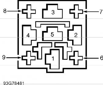

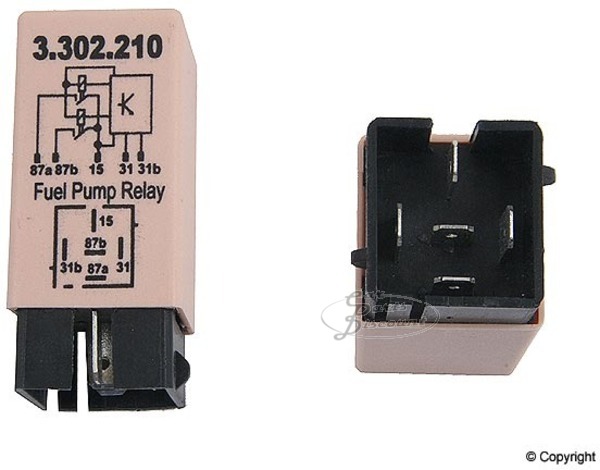

Normally I'd link a bunch of stuff but I don't have time. It very much sounds like you have a bad fuel pump relay. It's under the fuse box.
When it's NOT starting there is a way to bypass it with a wire or paperclip to check to see if it cures the problem. No fuel at valve intermittently sure sounds like a bad relay.
Do a search for fuel pump relay diagnostics or testing. Lots of articles on it.
There is a different relay for turbo and non turbo, at least for my year.
Member "Rspi" might have a diagnostic video on youtube.
Attached Thumbnails Volvo 850 Turbo stalling and sometimes starting-fuel-pump-relay-103.jpg   Volvo 850 Turbo stalling and sometimes starting-fuel-pump-relay-connector-diagram.jpg   Volvo 850 Turbo stalling and sometimes starting-fuel-pump-relay-volvo-850-1996.jpg

Thanks a ton, looked up the video, dropped the paperclip in, started up first try! Have the part ordered, hopefully this will be the extent of my problem!
