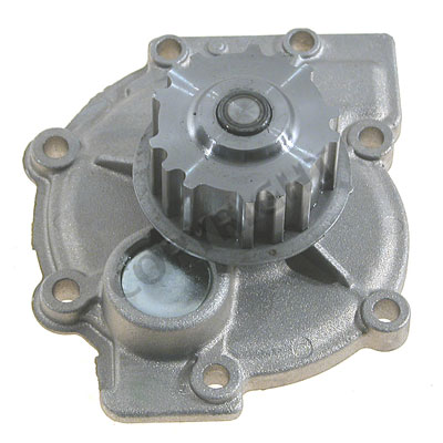

I wouldn't bet my engine on my water pump outliving my timing belt by twice. You can likely do a pump every other belt but do you really want to bet YOUR engine on his pumps history ??
Belt and pump is a maintenance service. Saving the $30-$60 bucks on a pump between belts just doesn't make sense in my world when you figure how much per month, mile or year that replacement adds to your cost of tearing down the front of the engine to do the timing belt alone.
Do you really want to be going to the salvage yard looking for a head and the down time just to save a few bucks when you know it's an interference engine and you'll likely take the head out if it snaps ??
I like my 850 and I'd rather replace a good part early then do a head job later. IMHO that's just the way I think. I'm running an Oreilly lifetime pump.

Lifetime for 70,000 miles? Lol, I do appreciate you guys input but not being able to work a real job or full time for over 3 years makes it real hard to toss a good working part in the trash. I do realize that the tb path is critical but these parts are better than 70k.
Having had Volvo parts last 300,000 miles, maybe I have to much faith in them. Come to think of it, I am known to be a little frugal too.
