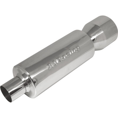

And don't forget the necessary "fart can" to make it sound .... ah ..... well ..... someone thinks powerful. First thing they do is get rid of the muffler and resonator if it has one and hang that big round muffler at the back of the car so it sounds like a hoover vacuum taking off. Usually the rest of the exhaust is still small, stock and a bit restrictive. Repeat after me, ricer.
Back when I was young (yes they had cars then) we used to think it was cool to put glasspacks on. They were loud, we got noticed but usually they sounded like power and they did help produce a little more power. When I hear that tinny high ringing and all I see is slightly modified exterior, stock engined Honda or Acura trying hard to get to 40 MPH with the throttle floored I can't help but laugh.
That's just me, just my 2 cents.
