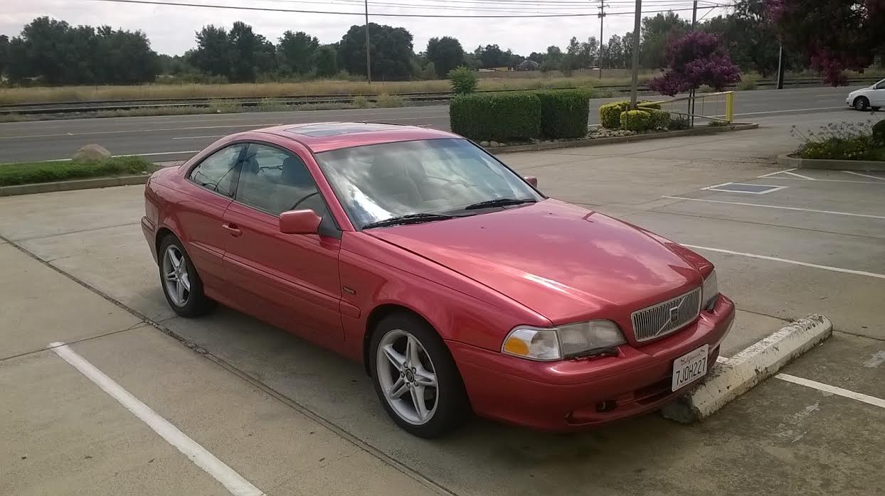

what colour is this. cannot find any colour codes 1998 c70 in person sort of a copper/bronze, bought is for 1200.00 152000 miles 1 owner, took European delivery.. have all the records..
Old Jul 13, 2015 | 04:04 AM
MSGTUSMC's Avatar
Joined: Nov 2011
Posts: 512
From: Chesapeake, VA.
Volvo code 428. My 98 is an exact match to yours. Coral Red metallic. https://www.volvoclub.org.uk/paint_colour_codes.shtml
