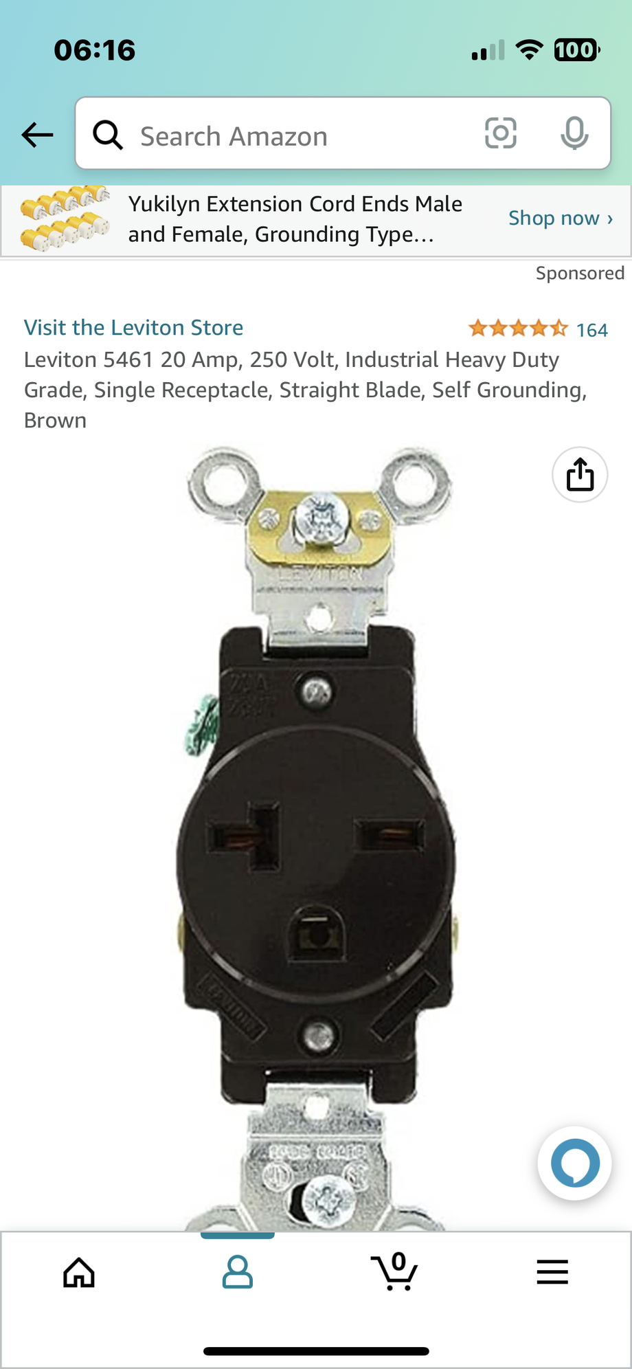

Default Outlet
Just have electrician run a 220 line to an outlet like this one. I did and now I get a full charge in 4-5 hours from empty
let me add that with the 110 prior to the install of rhe 220 it would take 13 hours
